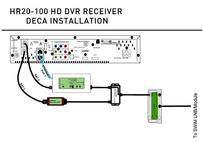

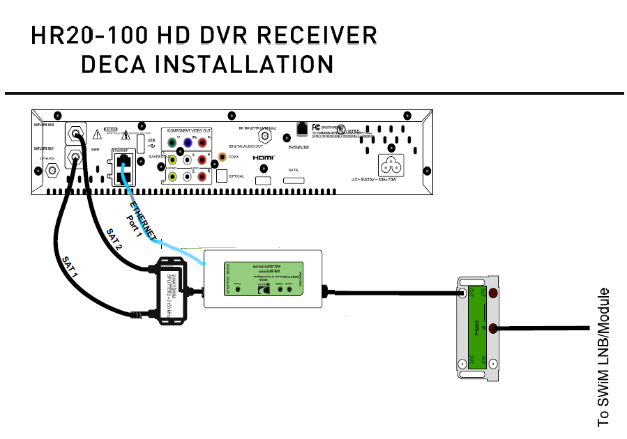

They are powered from the Sat 1 port. HR-20-100's can't so there is a work-around to get from the Sat 2 port. HR20.PNGHR20-1.png
