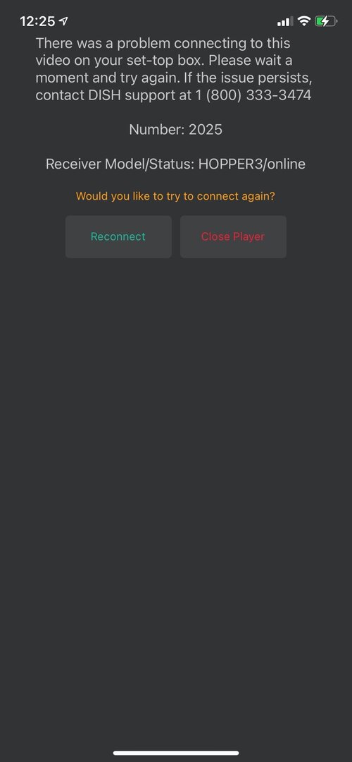

Just got the adapter today. Can confirm it does not work with Dish Anywhere. I pick a live channel (which is what I want) and it gives me an error about it being disconnected from the hopper. Unplug the adapter and it plays fine. I tried casting to my Roku 3 and it almost worked but video skipped every other second eventually crashing my Roku 3 so hard I had to unplug it for a few seconds since it was locked up.
