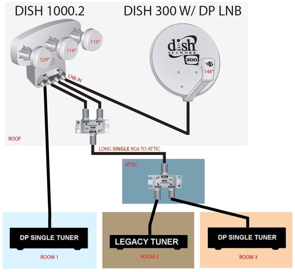

Hi, my main objective is to run only one RG6 cable to support two single tuner receivers with the use of two DP Plus seperators. Am I able to do this with these DPP seperators and if not, is there another way to accomplish this? I made a diagram to demonstrate my planned set up. The satellite location is quite far away from the attic entrance and Rooms 2 and 3 are adjacent to each other, so it would be convenient if there was a way to run only one line.
