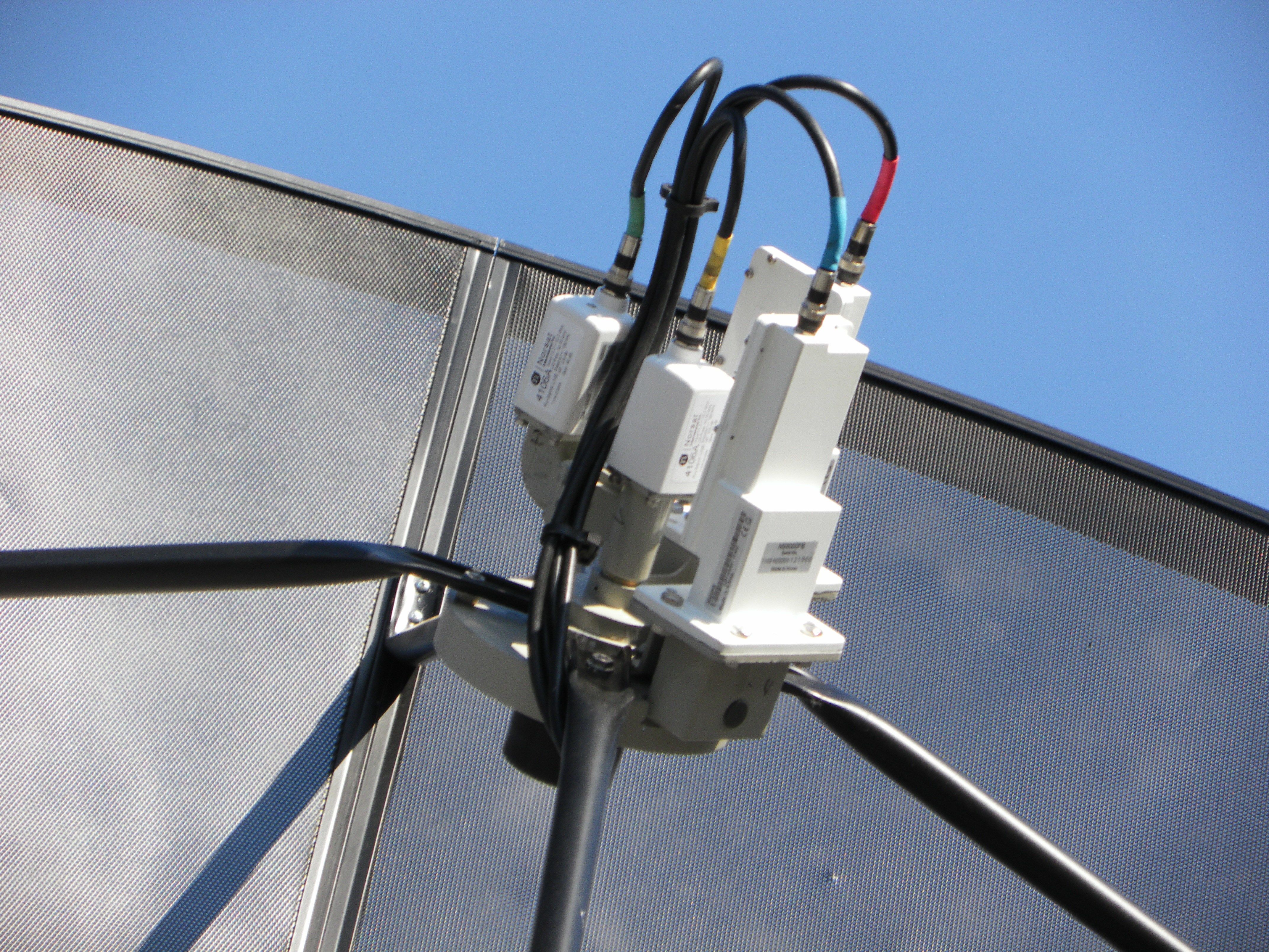

I went with colored shrink wrap. Didn't want to take a chance and get mixed up with even a temp solution. :)

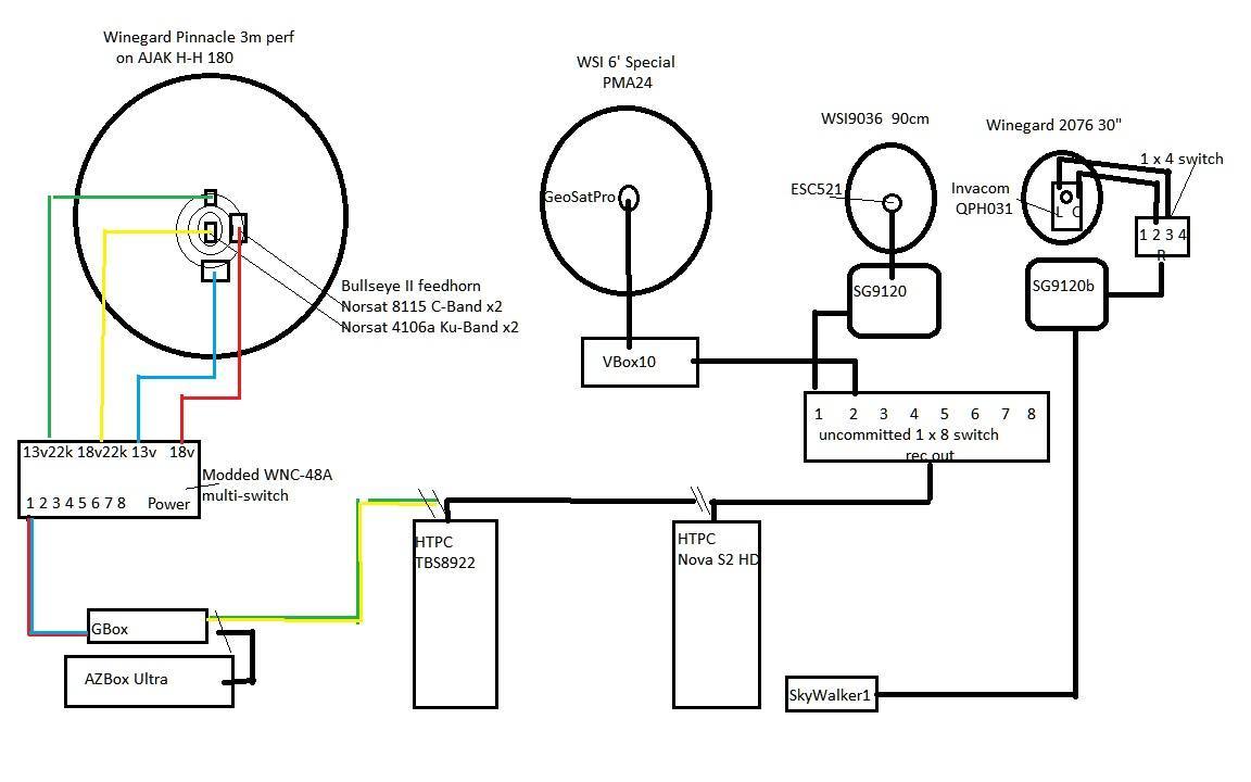

I tried naming cables but I changed stuff around so much the names just made it more confusing. And was always relabeling, not good. So I went with color coding and keeping a diagram on the computer to refer too.
