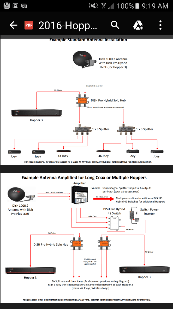

I wonder if the DISH 1000+ dish will need hybrid LNBs for the new DPH42 switch!
I Don' think it would. I mean the whole purpose of the switch is to allow you to use regular lnbs to power the switch and accomplish what they can do now with the new hybrid lnb. This also means you can use more than one dish or bigger dishes for each sat location to prevent rain fade. But who knows , you might be able to use the hybrid lnb and the switch deactivates the lnb, in place of the switch?
Thanks MikeD-C05. I think you are probably correct. This sure is exciding we are getting closer to the new DPH42 switch. I can only imagine how nice it is not to have any more conflicts when I switch to the Hopper 3.
Looks like you can use DPP.
But I'm not seeing where you can add a 4th orbital location.
Maybe through that Amplifier/ switch.
I have looked at that diagram. I am going to use only one DPH42 switch for two Hopper 3s and four Joeys, no amplifier. If you look close at the new switch there are four ports so it appears to me it will see four satellites for a 1000+ dish. The amplifier appears to only have three satellite input ports.
Reactions: Troch77
But there is, unfortunately, a power inserter, so one more precious electrical outlet used up in one room and NONE left in another room, but I think I can move things around to provide an outlet for the PI. However, I shall view the glass has half FULL. I look forward to multiple H3's.
Sounds like you need one o' these...
He, he, :). That was funny. What's embarrasing is I have TWO UPS's with TEN outlets each, in EACH room. One room can accomodate the power inserter because I do have two free outlets. The thing is that in the other room two 10 outlet UPS's is still not enough. For that room I also connected a TEN outlet surge protected multiplier (almost full) on another wall outlet for less critical things. What I will do is disconnect one device from the battery outlet of one UPS (a less critical device), and reconnect it to the surge multiplier so that the Power Inserter of the DPH42 has battery access so the DVR keeps recording in a power outage. It can be a pain to access the rear outlets of the UPS in that room, but it can be done for the love of an H3.
Why so many oulets and devices? I have a lot of other legacy Consumer Electronics in that room that I still use today: SVHS, DVD Recorder, Turntable, Audio Cassette, dbx Compander, CD Recorder, CD Player, are just a few, and we have not even gotten to the Blu-ray disc player. So, I think you get the picture. It even amazes me sometimes. :).

Looks like its coming January.
Doesn't look like H1,H2 are compatible.
But it does look like Hybrid LNB isn't required, and DPP LNB can be used.
http://blog.solidsignal.com/content.php/5979-CEDIA-2016-DISH-shows-DPH42-Hybrid-Switch
OK, but something that's confusing on large picture with the "long coax or multiple ho's" in SS's link...there appear to be 4 coax runs from the dish, (into the Sonora box) but the sign for the dish says "DISH PP Hybrid LNBF". Where are they getting (4) feeds out of a DPPH LNB...when they only have 2 outputs???
