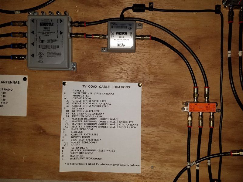

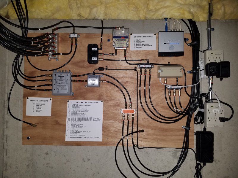

Well, finally got a DPH42 switch installed with a Hybrid Duo Hub for my two HWSs and one Joey 1. Using one dish, a Western Arc 1000+ that sights in four birds 119, 110, 129, & 118.7. It has been a long road, getting close to the end to a Hopper 3 system. Thanks for all the help from members in the SatGuys forum, DIRT members, and retailers JSheridan & Mark from DishDepot.com for all your help. Also, thank DISH for developing the new DPH42 switch. My next step is to message a DIRT member and see what I can do upgrading to a Hopper 3 system. If no luck there I will contact DISH customer support and request the higher up department and go from there. Here is a couple pics of my redneck head-end board.
