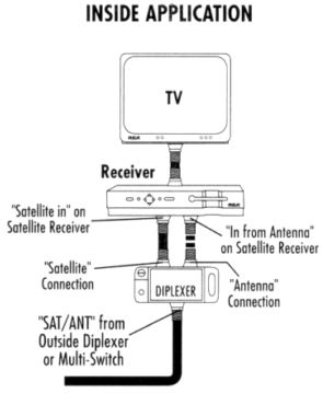

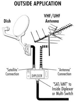

Here is how I setup earlier (see attachement outside/inside)

is there a way I can test "diplexor" ?
