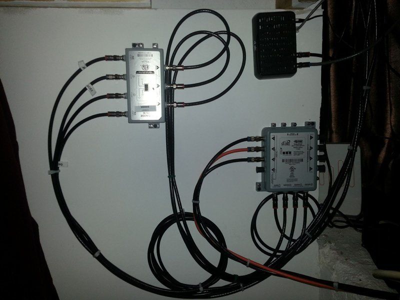

I have my switch and node inside in a closet for easy access and out of the weather. Plus don't make the outside look tacky with the extra loops of wires.
Sent from my iPad3 using SatelliteGuys

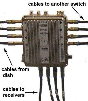

Great. Any idea what the different numbers on the Switch represent?
Depends on what numbers you are referring to. If it's just the numbers on the switch by the connectors, the ones on the left and right are just labeled 1 2 3 4 for sats 1 2 3 & 4. Connect the dish lines (1 for each sat) on the left, the right is for adding another switch. The ones on the bottom are 1 2 3 4 for receivers 1 2 3 & 4. The power inserter must always be used on receiver port 1. A receiver can be hooked to the power inserter however when dealing with Hopper nodes this is not the case. For the solo node use ports 2 & 3. For the duo node use ports 2 3 & 4.
