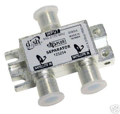

NO. SW64 is Legacy switch and will not work with DishProPlus switch. Is any of your receivers Vip models? If so, you can use separator and feed dual tuner with sigle output and free a slot for additional single tuner receiver. One DPP44 can actually feed 4 dual tuned receivers with separators.
