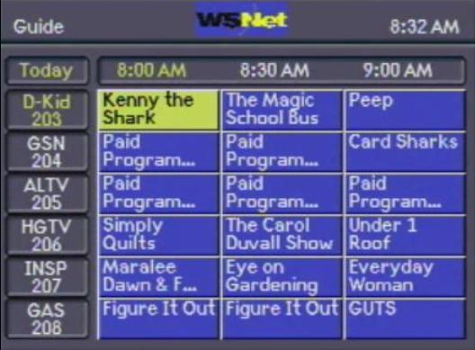

Hey guys...I just subbed my "WSNet" unit via Programming Center - it still says "WSNet" abd although "Guide" shows me a list of channels, there is no program info.
Update - I have a guide :)
Still says WSNET
