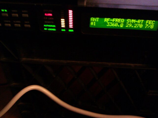

I am using a dte-7100 receiver and it seems whenever I lock in H signals. I am unable to manually enter and tune vertical signals. For some reason it won't let me switch. I have it slaved VIA Openbox. Even when the channel on the openbox is on the desired polarity the digitrans will not tune in that polarity. I am not sure if there is a setting I need to switch but it is very inconvenient.

Well I had the H transponders working on DC2 the other night when I discovered I and Q modes. But the receiver will only do either H or V for some reason. The other day I am not sure what I could have changed but now all I get is V no matter what I try. It did that to me when I first got it when trying to access the Ku Canadian locals. I was never able to get the other polarity. I am feeding it a good signal too through the S9.
OK I went below 600 on the frequency and BOOM the transponder locks again for horizontal. I do not understand why the magic number is 600 though.Thanks for the tip I never would have figured that out.

OK when I rescanned all the channels with my new LNB I didn't notice that the H transponders are 600 lower. Now everything makes sense. I don't have a manual for the LNB. It makes sense now why some receiver menus have a 5750 setting.
I just found the 5750-5150 5150-5750 setting in my openbox menu. I switched it to the former and now all of the transponder numbers scan correctly. Learn something new every day!
