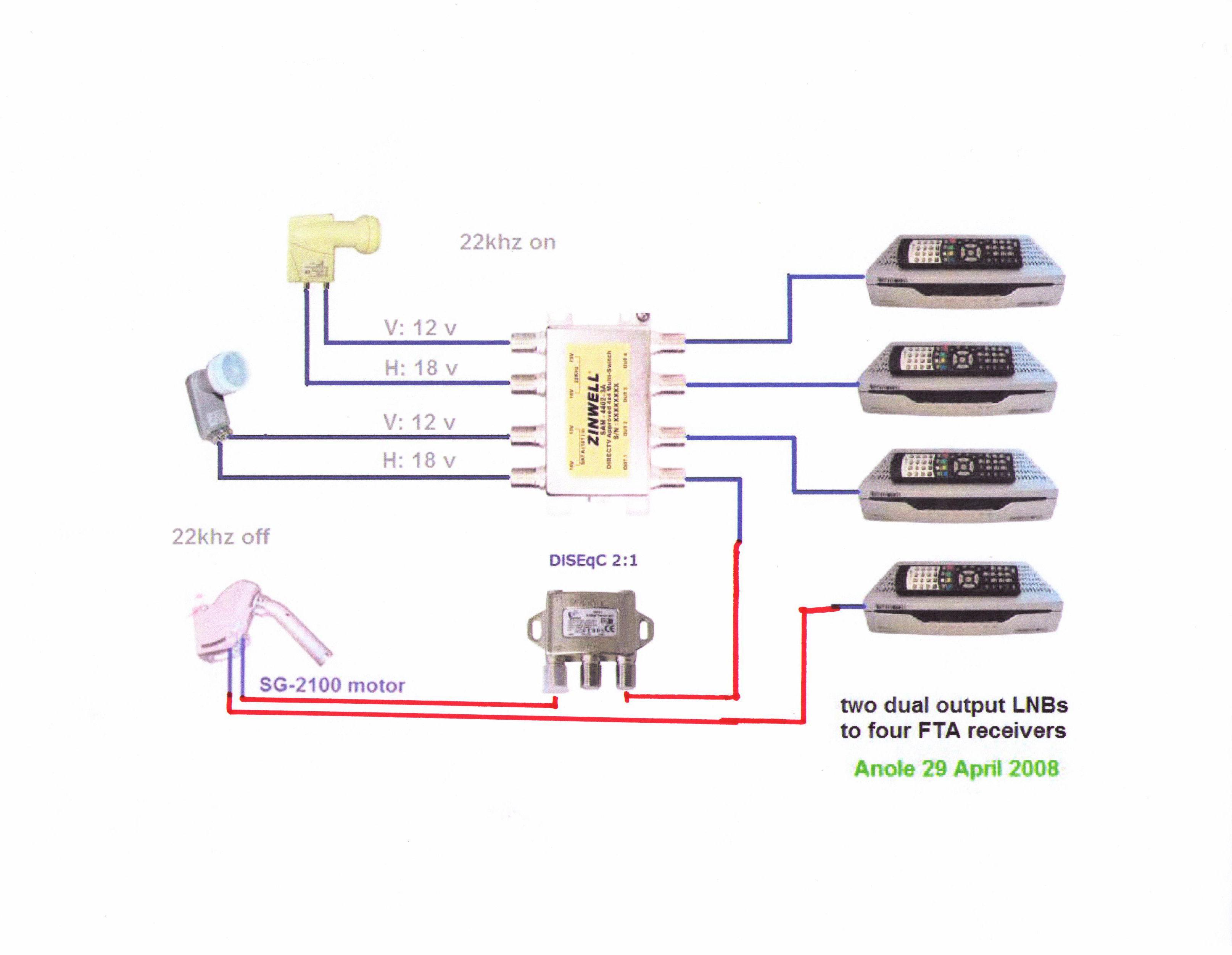

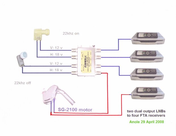

you're getting close:
Unfortunately, in the first picture, you've got a 4x1 disecq input feeding the 2nd receiver, so that won't work.
In the second picture, you've got the correct multiswitch, but it's not really rigged up properly for the job.
See drawing in post #7 of the Switch FAQ: Multiswitches.
Just make the following changes:
- put the motor between any receiver and a multiswitch output
- hook two LNBs up as shown, or...
- on a QPH-031, hook up the two L LNB outputs in place of the first LNB, and the two C LNB outputs in place of the second LNB shown in the diagram.
- I would hook the C outputs to the 22khz On side of the multiswitch.
- see picture on Sadoun's page for output labeling of QPH-031
- There is no expansion to more LNBs without added complication.
- Review what I said earlier about it being a waste to put the QPx-031 on a DirecTV dish.
. . . (sometimes when we get too close to a problem, we cannot see the forest for the trees)

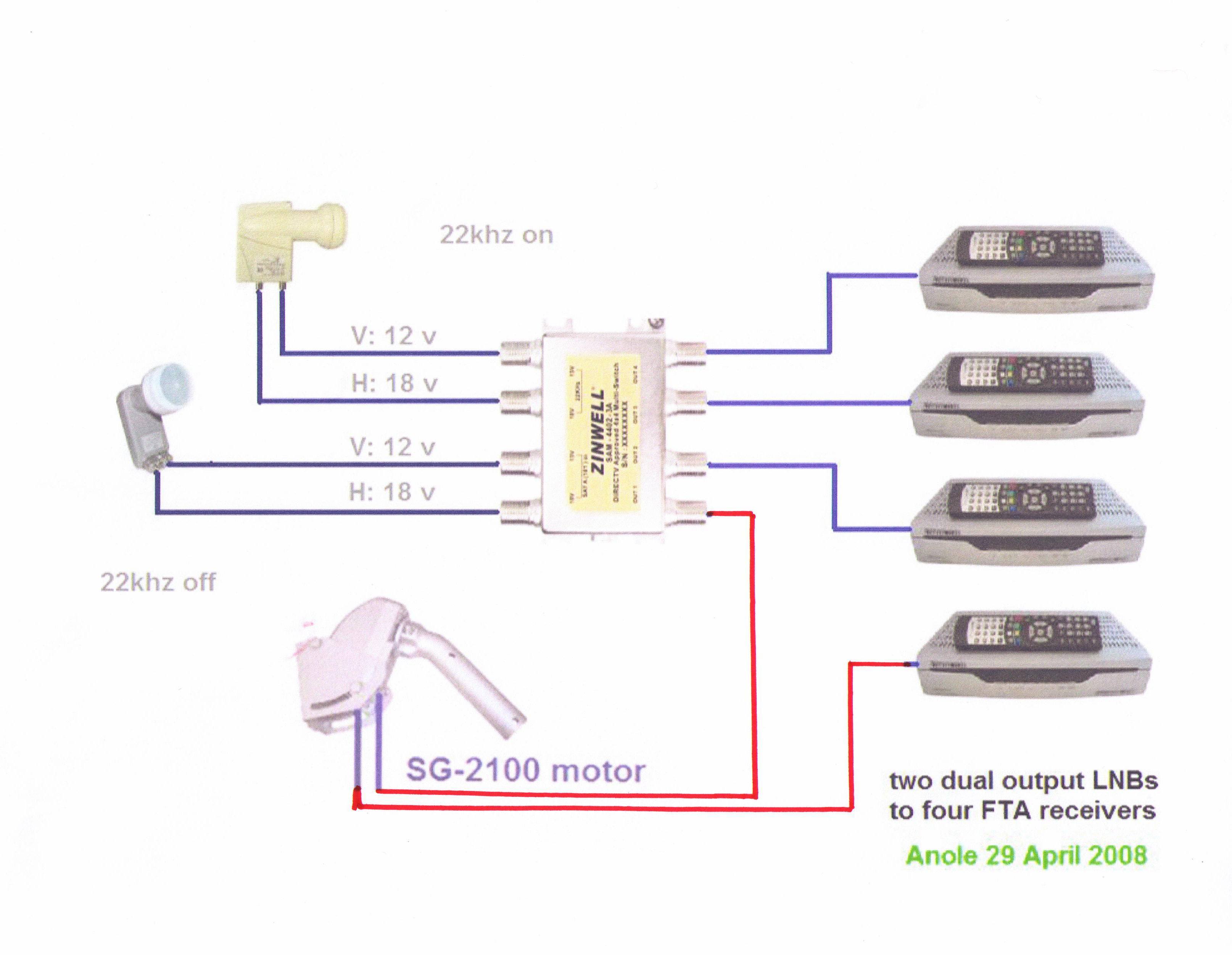

Thank you for correcting me, here's some adjustments to the diagrams. About the QPH-031 I'm just going do it in the near future with the 39" Fortec Star . I will stick to my DTV for now. I'll try hook up my FTA tomorrow and I will inform you if there's any complication to my setups.
I truly appreciate your help:) a million thanks to you!

... here's some adjustments to the diagrams.
Good work. Use your first drawing, the one on the left.
The one withOUT the diseqc switch.
Sounds like a fine plan on the dishes.
Looking forward to your results, and a photograph.! :cool:
