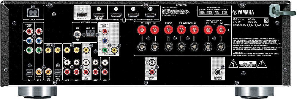

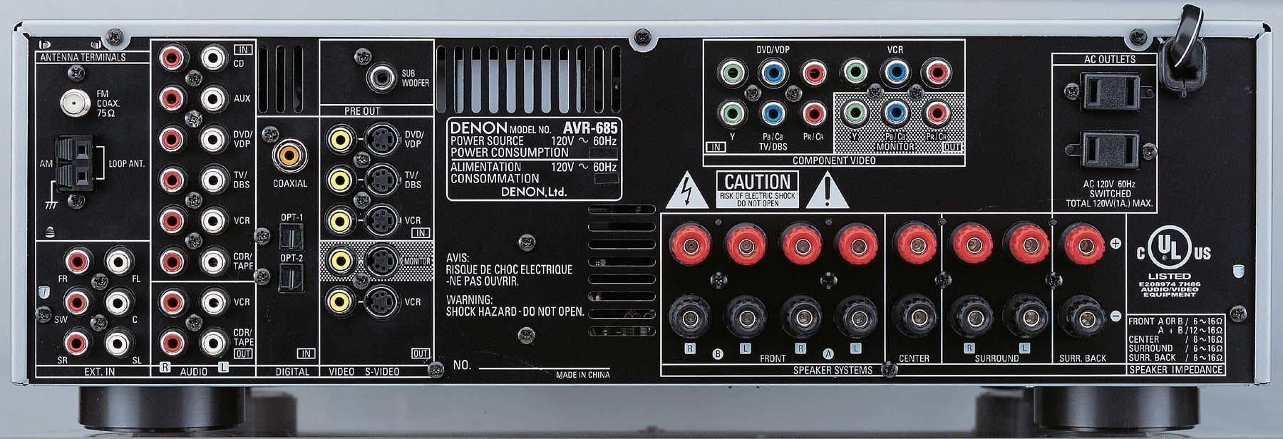

I have a Denon Receiver with 4 HDMI in-puts, could I run the 2 DVR's thought it then one line to the HDTV?
I only have 2 HD in-puts on my HDTV so I will have to run my DVD player into the receiver I guess.
Yes, that's how I have things set up. I have an HTPC, two HR2x DVRs, a Wii, and soon-to-be an Xbox 360 all running into an A/V receiver, with one HDMI cable running to the HDTV.
I made a error the Denon only has 2 component hook-ups but I have a Yamaha RX-V567 the is a year old that has much more connections.
