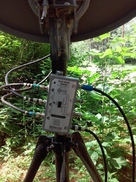

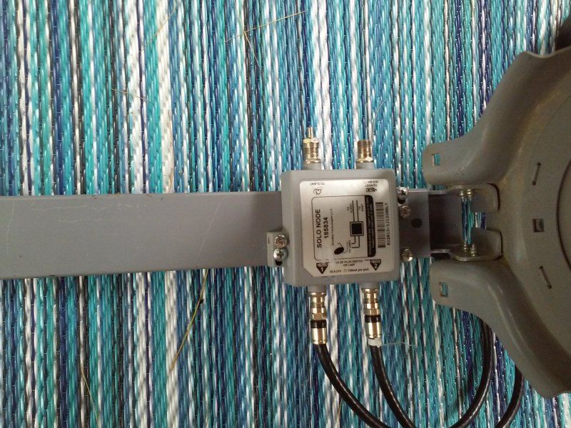

Here's how the Duo Node is mounted on the permanent cottage mount, and the Solo Node on the portable LNB arm. The blue coax on the Duo is a temporary connection to the RV when we're there, and that port gets terminated when we're gone. Anything I should be doing differently?

You just want to make sure that the cable runs downward so water runs away from the ports
