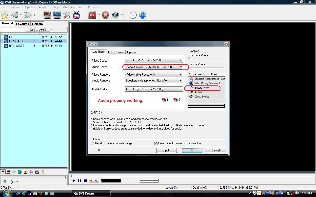

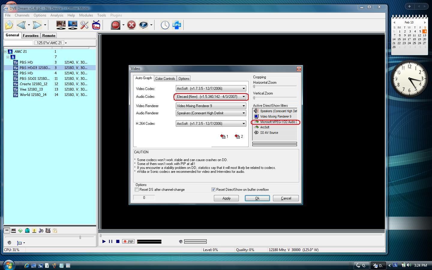

Have no audio when this codec is shown and can't change codec via codec menu. Anybody know how to fix this?

In first screen shot you can see that Elcard is selected as the audio codec I want to use. The software should apply this codec and it does not. It selects Microsoft MPEG-1/DD and that does not work.
I looked in the guids.ini and could not find the microsoft mpeg-1/dd codec or I would have removed it. That codec seems to be keeping me from hearing any audio.
For some unknown reason the Elcard codec will appear in the software and start producing audio.
I'm running Vista on two machines one has intel Pentium and other has AMD. Problem is not specific to one machine.
Also when I right click on any of the devices listed in the right side screen A window particular to that device pops up with information about that device. When I right click on Microsoft mpeg-1/dd it turns blue and no information is displayed.

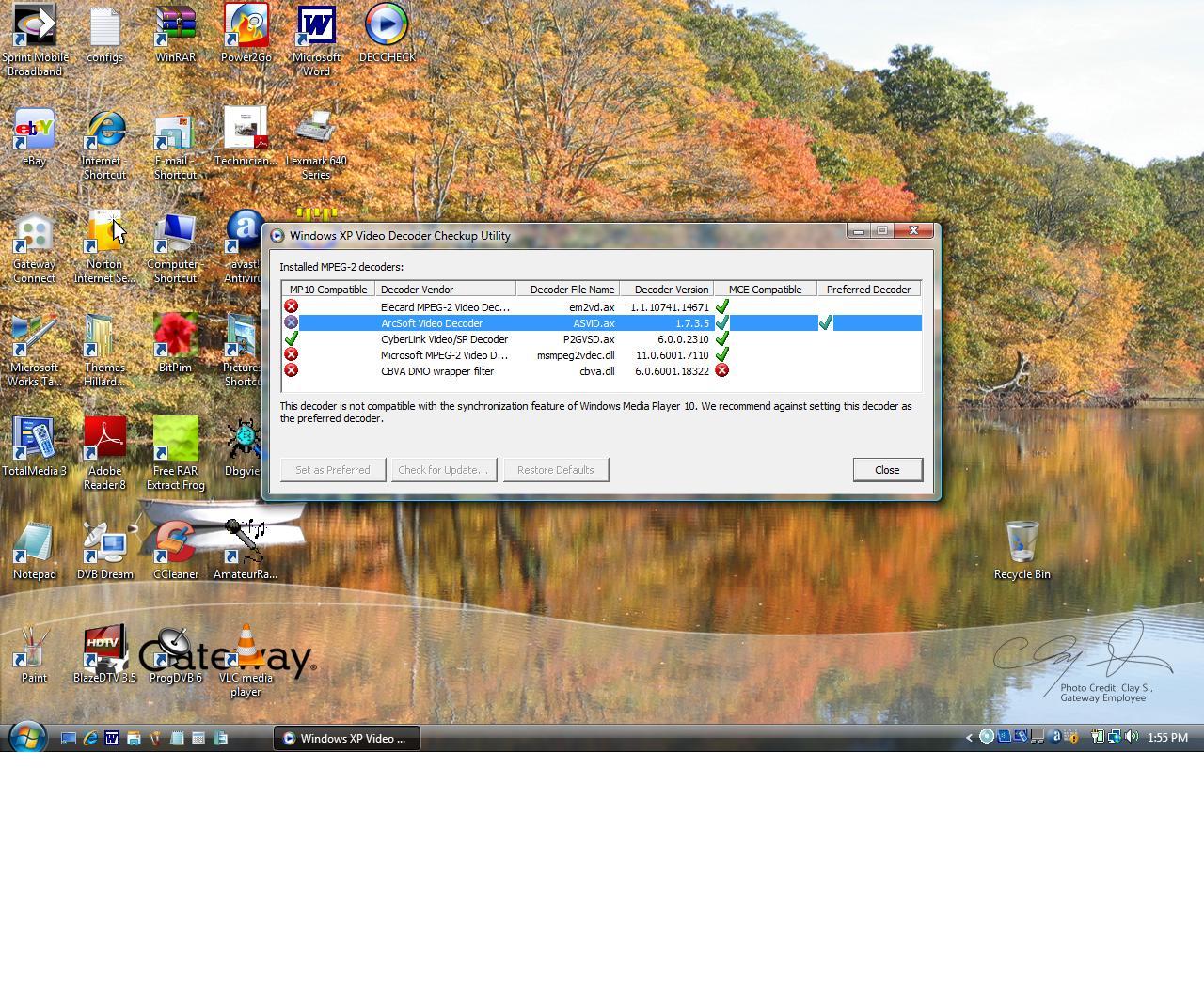

I'm not familiar with Graphedit and do not know how to open the current graph in DVBDream.
I'll try to find that MS download utility for viewing what codecs are installed, I don't remember the name. Do you know?
Microsoft MPEG-1/DD Audio Decoder
Microsoft MPEG-1/DD Audio Decoder is not found by the MS codec check up utility.
