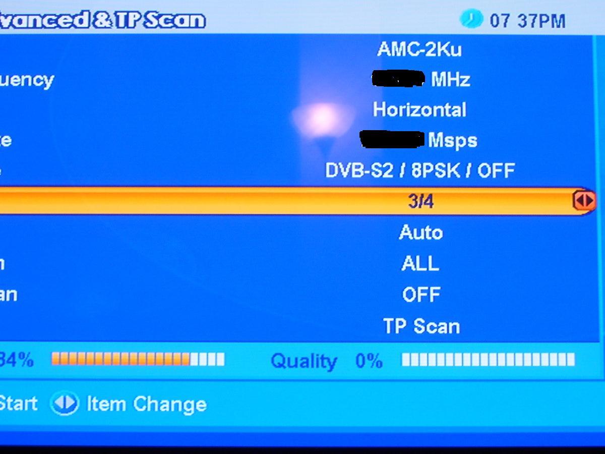

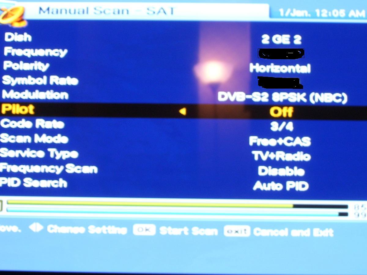

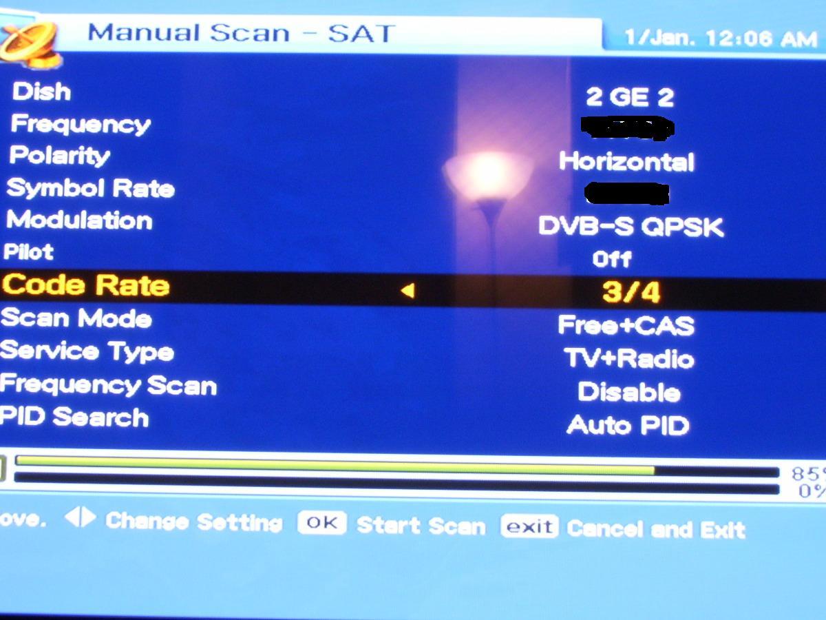

Here is the proof. Just took a couple screen shots of the Coolsat 8000 and the Pansat 9200
1st pic is Coolsat 8000 showing the DVB-S2 feed at 99 quality :)
2nd pic is Coolsat 8000 showing what happens when its set to DVB...0 quality :(
3rd pic is Pansat 9200 on same feed with 0 quality :(:(
transponder info has been blacked out...and I guess I cant have my light on in the background because it shows up on the pics ;)

Did you have to set the FEC or did the Coolsat select it automatically? I wonder why the modulation says: "DVB-S2 8PSK (NBC)"? NBC uses 8psk, but it's not DVB-S2.
North American MPEG-2 Information
the difference is the fec.
regular dvb-s can use 1/2, 2/3, 3/4, 5/6, 7/8, 8/9, etc but there are variations as well, boradcom has one called turbo-fec there are two DTH providers in NA that utilize this, no regular truefta that Ive seen though.
dvb-s2 is 8psk, its the same, it has regular fec's but then there are some variations, like trellis fec and again turbo-fec .
if a tuner supports dvb-s2, that doesnt mean it will also support turbo-fec or trellis, its accually highly unlikley. I have yet to find anything short of $1k that supports trellis :(
genpix sells a usb tuner called the skywalker-1, it supports turbo-fec, but not dvb-s2 or trellis.
