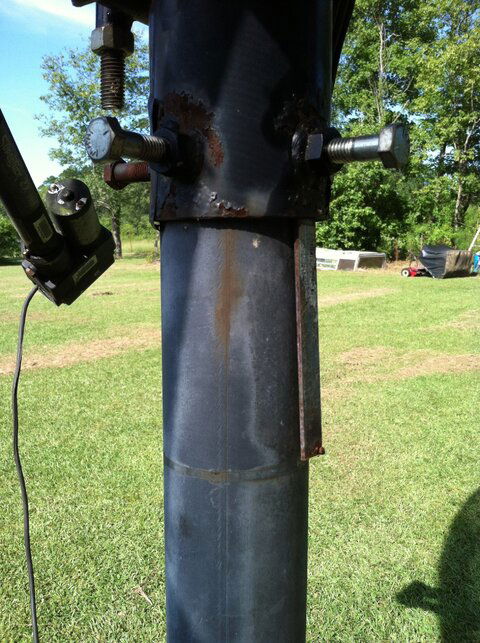

continued trying to tune 7 1/2 ft dish only to find the pole has drifted so its now not plumb. looks to be 1/8 inch out of plumb. its ok for tuning single sats but makes the arc almost impossible to track . can't fix today will have to be a future project the mount on this pole sits loose so i'm able to compensate a little to where its closer to 1/16 th out of plumb.

You can SHIM the mount itself on the pole to get the mount level. There's different ways to do it, but how I do it is to use a DIGITAL level (for exactness, Sears sells one fairly cheap), and metal (steel) pieces used as wedges. If you use wood wedges, and it gets wet it can swell up and cause problems. Loosen the mount bolts slightly, drive shim pieces between mount and pole until it's perfectly leveled in North-South, East-West. Alternately tighten the mount bolts slowly back and forth across from each other while observing the digital level to make sure it holds it's level in every way. Don't do the final crank-down of the bolts until you verify the dish is tracking well.

great idea thats exactly what i did ( i'll post pics ) i've been tuning the sat kinda redneck style vbox and tv at dish

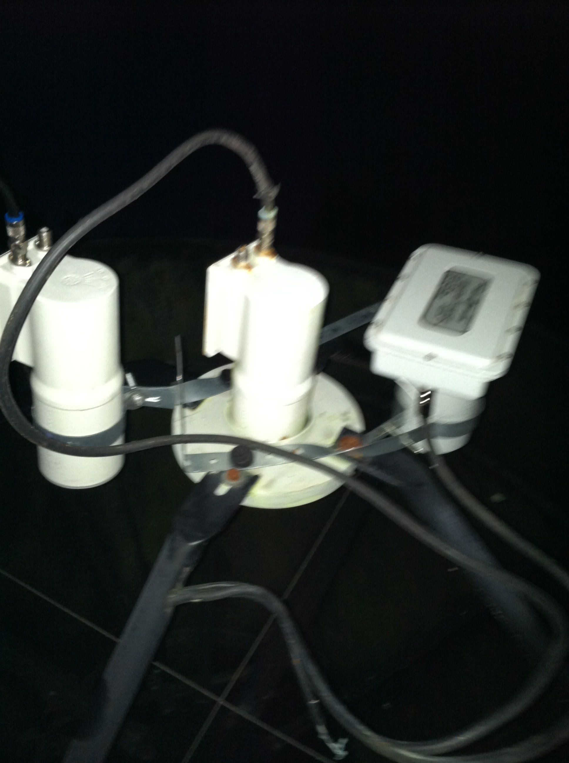

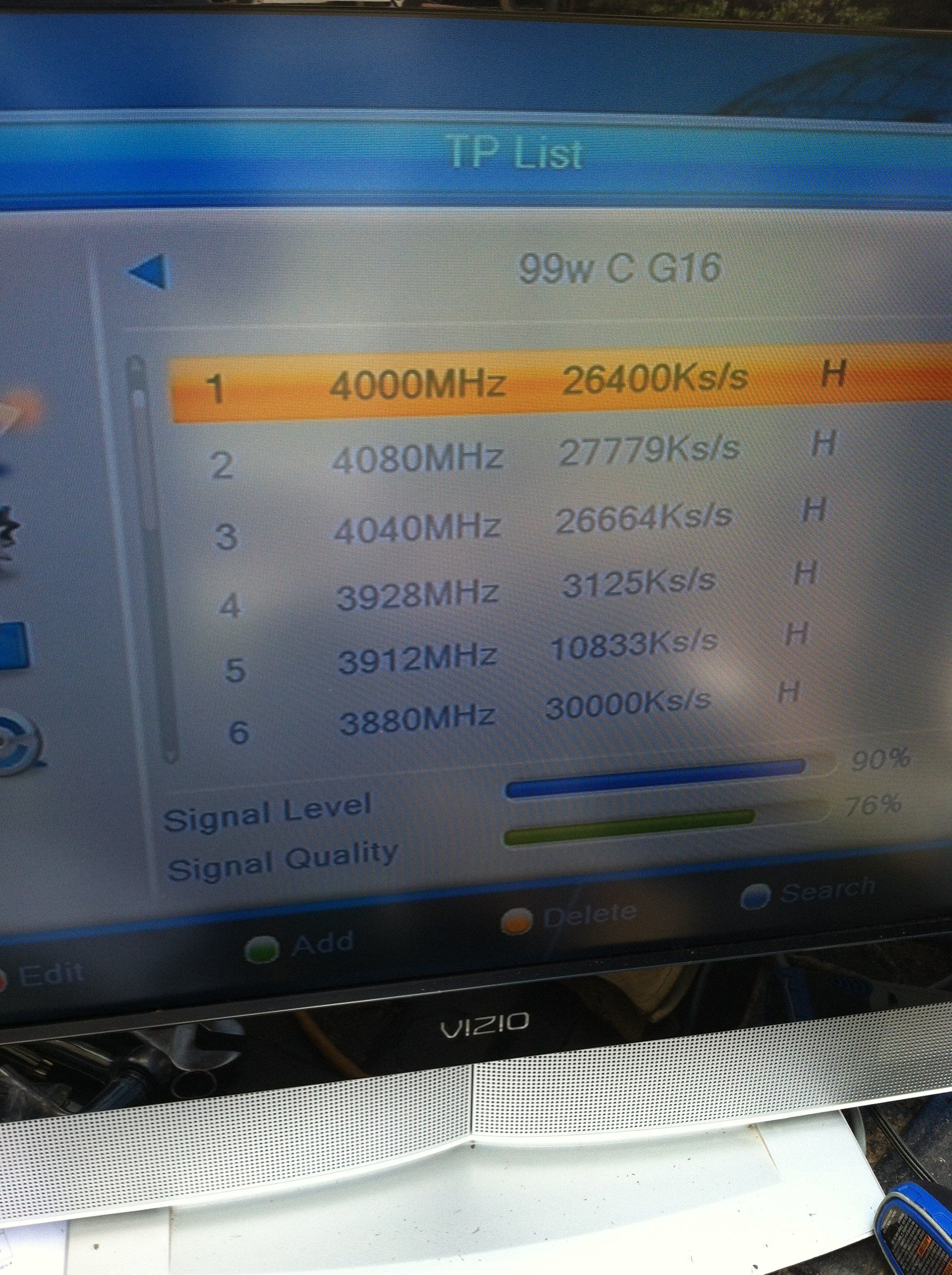

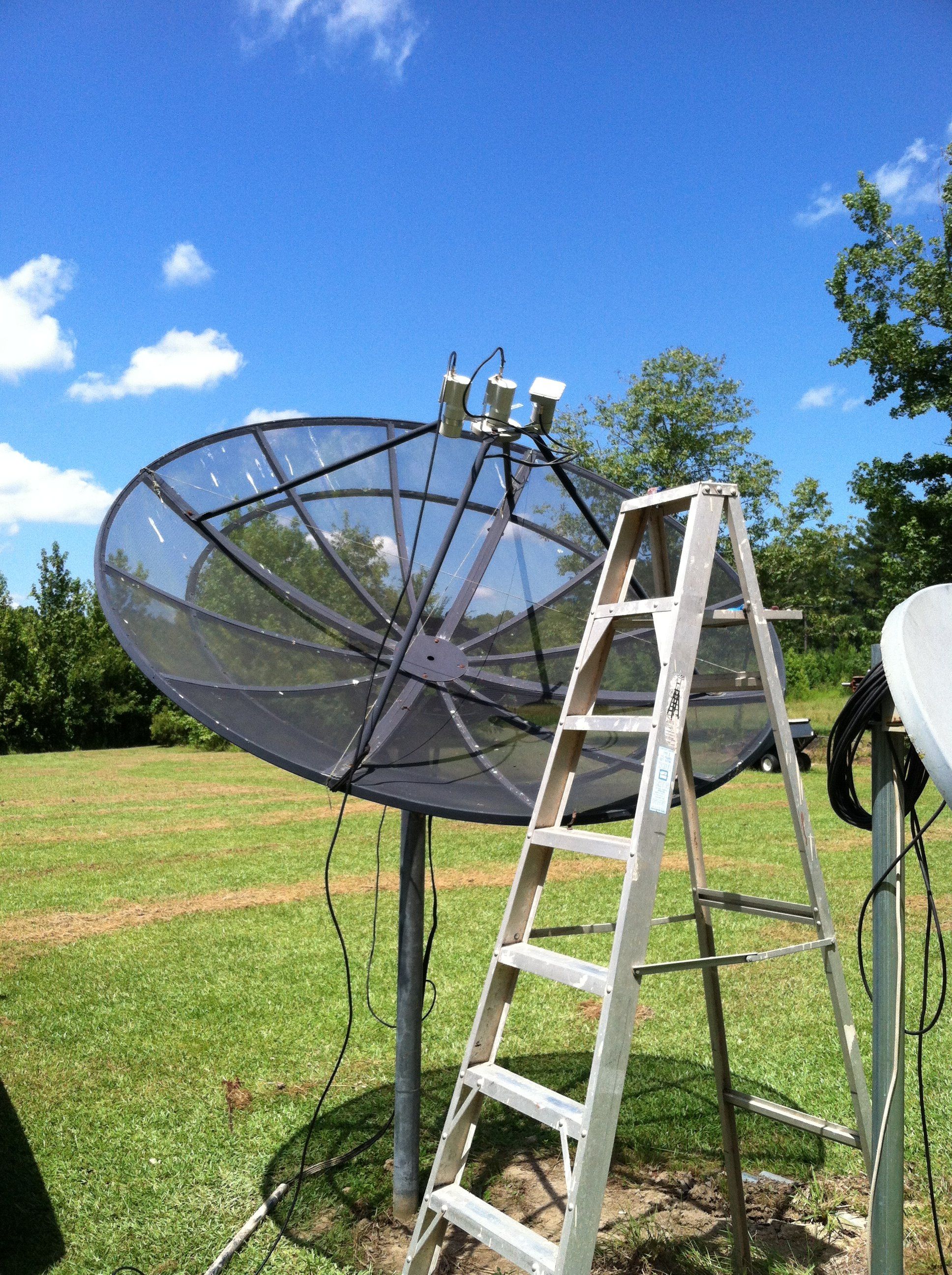

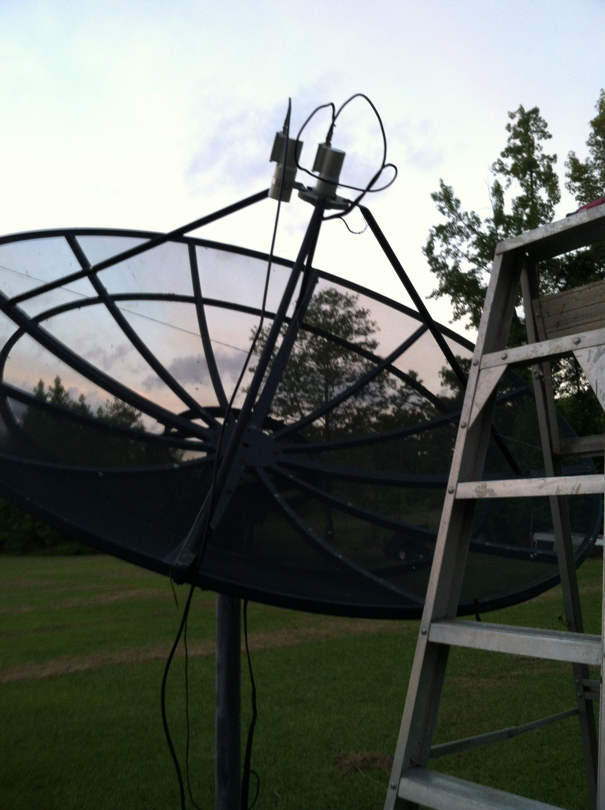

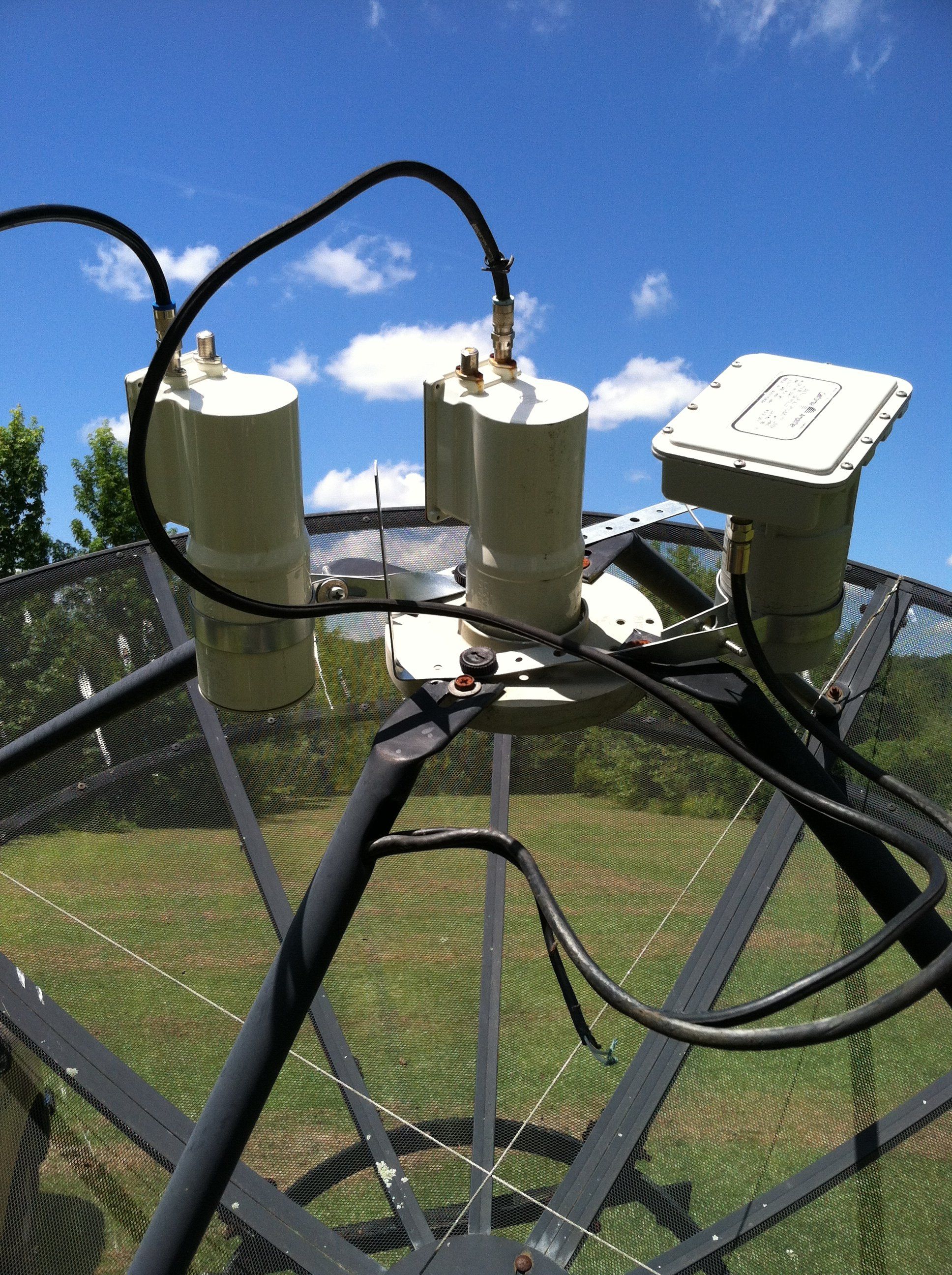

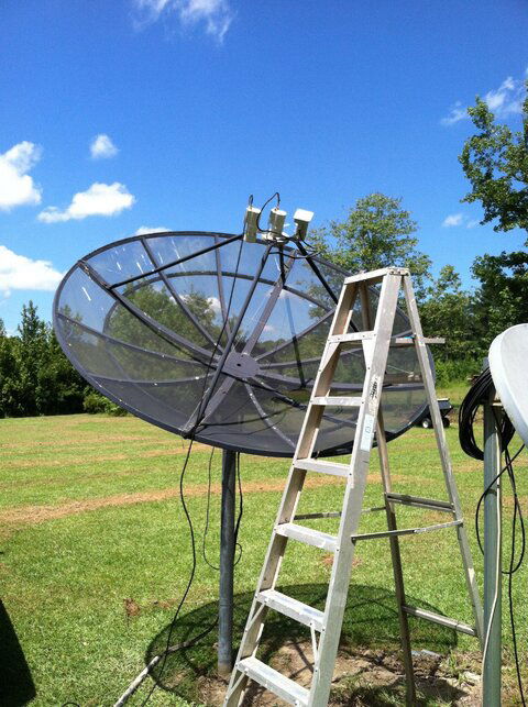

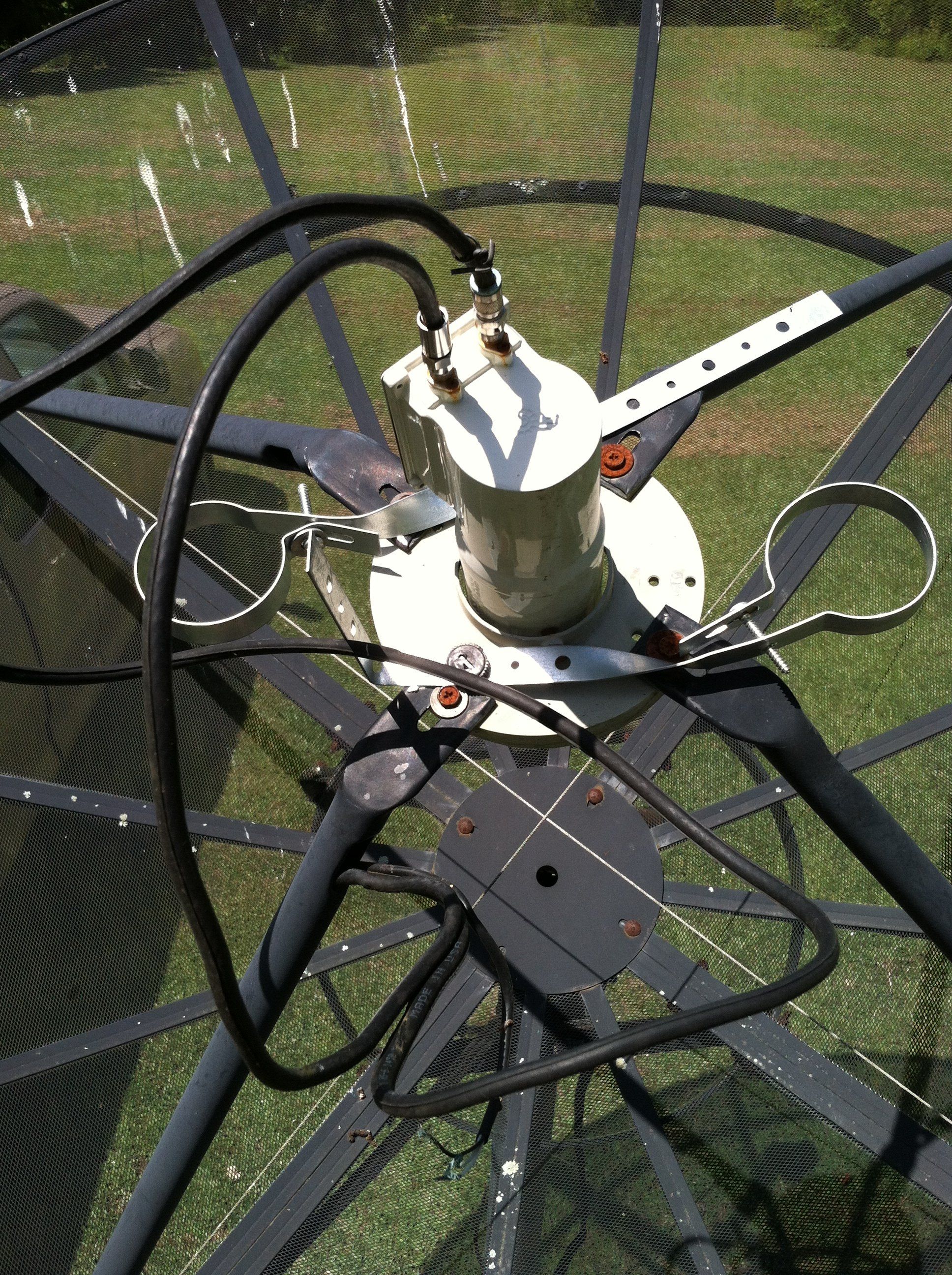

so i took a bit more time and developed a monster :) first it was a dual feed mount then added a third lnbf center lnbf gets 99 @ 70% left lnbf gets 91 @ 75% the lnbf on the right side gets 105 @ 35-52 % only on 1 tp it got dark and couldn't fine tune it much ( i was hoping to hit 103 )
first pic is shim second pic is two feeds mounted 91 & 99 , third pic is the triple mount

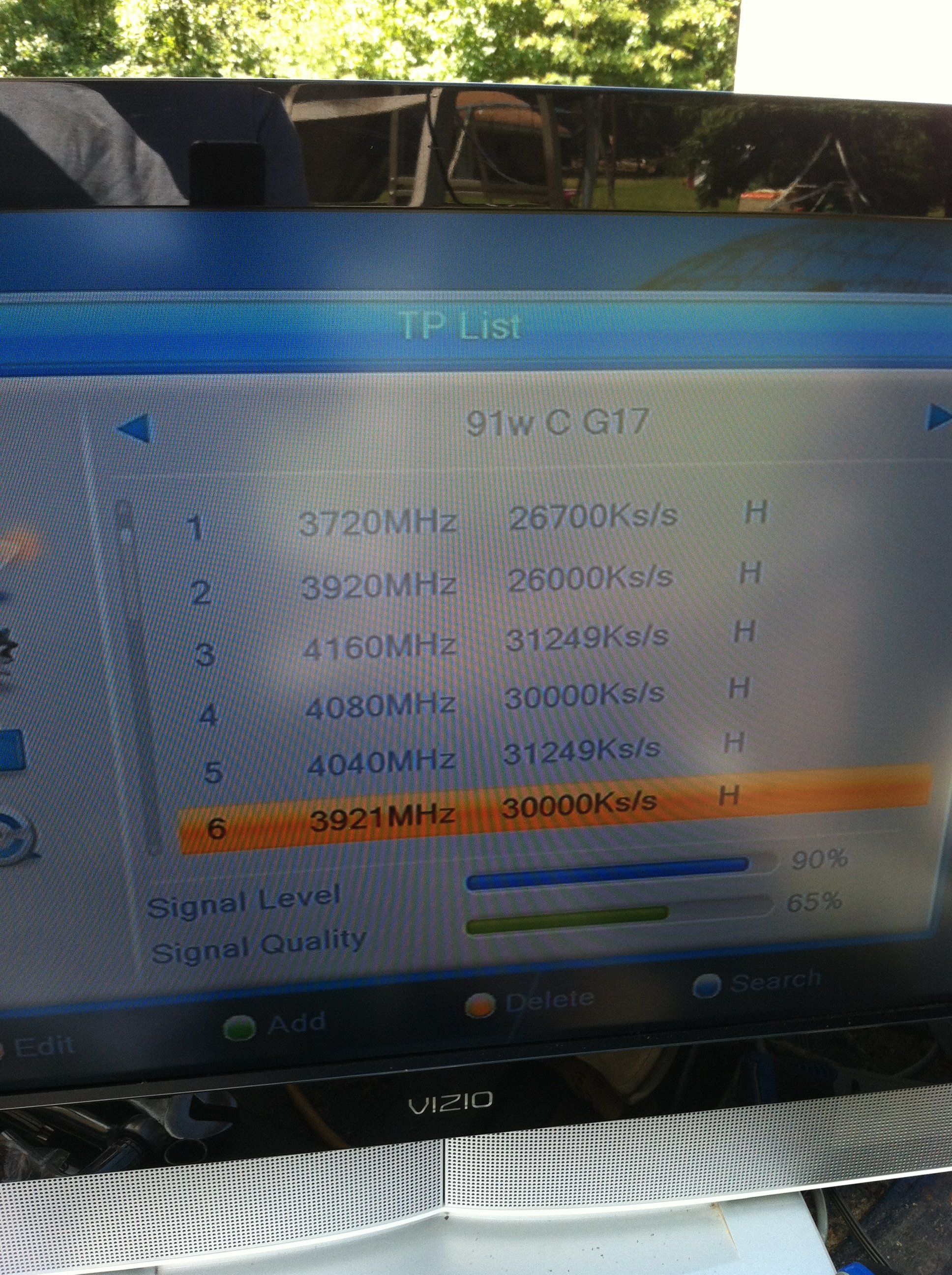

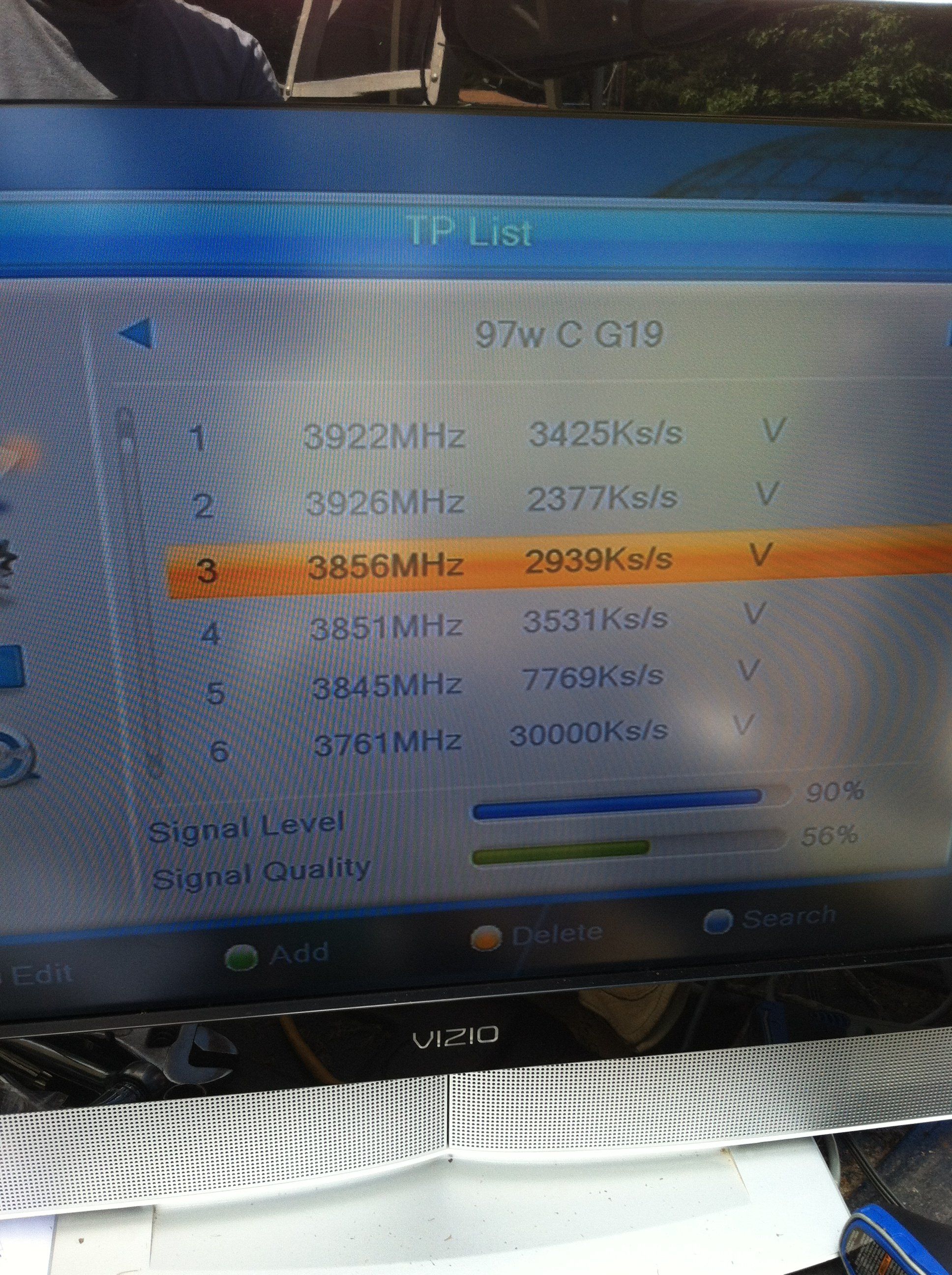

finished up project monster ( multi feed from 7 1/2 ft'er ) final conclusion
got 91 pretty good signal (S2) got 99 (good signnal for S2) picked up 1 mux from 97 (nbc S2 i think at 44%) and got 105 (mostly around 40-60 % ) so not bad for playing around .
