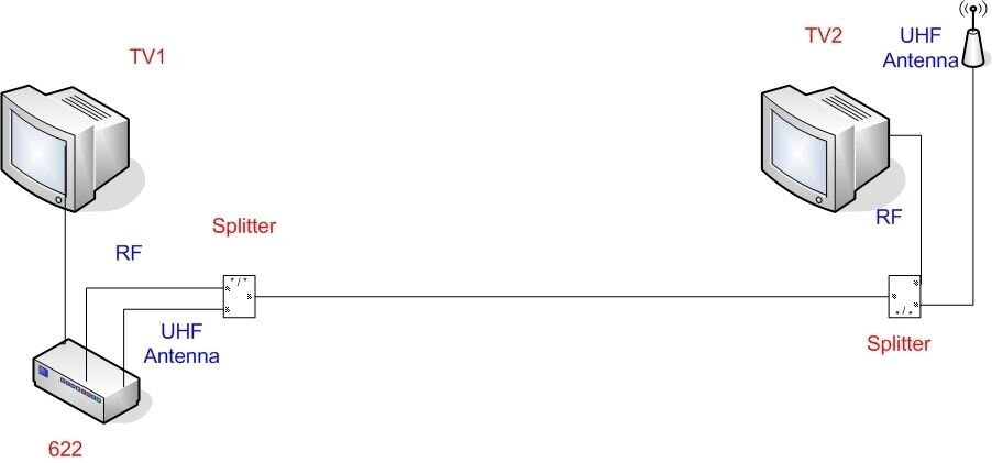

get (2) two way splitters and combine both the tv2 and the antenna together.
TV2 output coax jack, and antenna coax jack both go into the OUT legs of the splitter, and the IN goes to the original end you just unscrewed from the TV2 on the back of the 625.
now take the other splitter and remove the f-connector from the back of the 2nd television and put this end on the IN side of the splitter. Now take the antenna and put on one of the OUT legs and take a jumper and go from the other OUT to the back of the tv.

Are there any drawings (schematics) showing this setup? I want to make sure I do this correctly. If I understand this correctly, all I need to buy is 2 "2 Way Splitters"?
I did this drawing for John a while ago. It's the same procedure.
