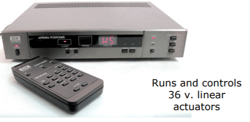

you know if it counts the pulses and shows it and if it works better than a vbox of the chinese new they sell me one DX Antenna DSB-400 used
I think this is% 100 Japanese
Hi
The DB-400 was manufactured in the mid 80's, so it is around 40+ years old and caps will likely need replacing. In my opinion, the V/Gbox will be more user friendly, but definitely not built to the high quality standards of legacy gear. Typically this type of gear is sold for the cost of shipping ($25 USD +/-).
The DB-400 will save and return to a satellite position, but does not display the pulse counts. Used as a manual motor controller and servo polarity selection, but without automatic positioning or polarity switching. You will also be limited to the few alpha numeric assignments for the satellite name display.
the one that they sell to me this practically new in its original box they never used, it they it stored $55+shipping
I have a DSB300 model and it doesn't do reed switch sensors. Only optical and hall effect type sensors.
and that for those of us who do not know what it means, or what it means

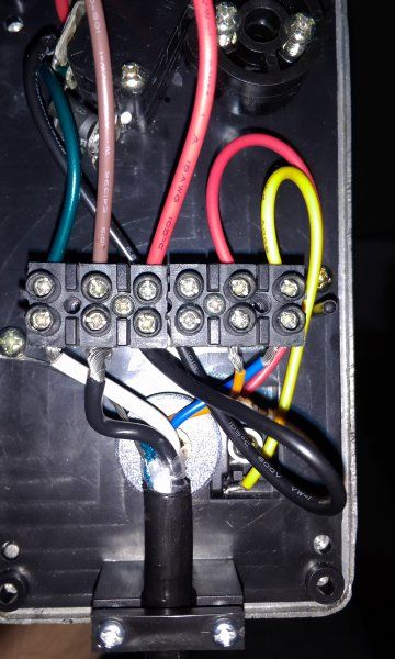

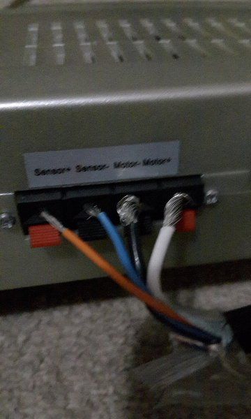

I most of all just want to move my actuator since I have a vbox II of the Chinese and it came out bad at times does not send pulses, mark error
The reed switch is a 12v two wire connection, the Hall Effect and Optical sensors are a 5v three wire connection. Your comment on the VBox II suggests you have a faulty reed switch or wiring though.
Reactions: Lone Gunman
The wiring is new is from the DX engineering
I have it connected in this way to vbox, to arm
View attachment 135731 View attachment 135732
I can't tell from the pictures if it's connected or not, but my understanding is that the shield of the sensor wires should NOT be connected on the actuator end, and SHOULD be grounded on the VBOX side, in order to be effective at suppressing noise in the sensor line.
Also, it would be good to put some solder (tin) on the ends of the wires
