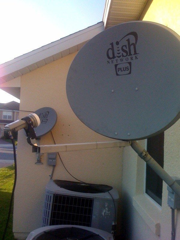

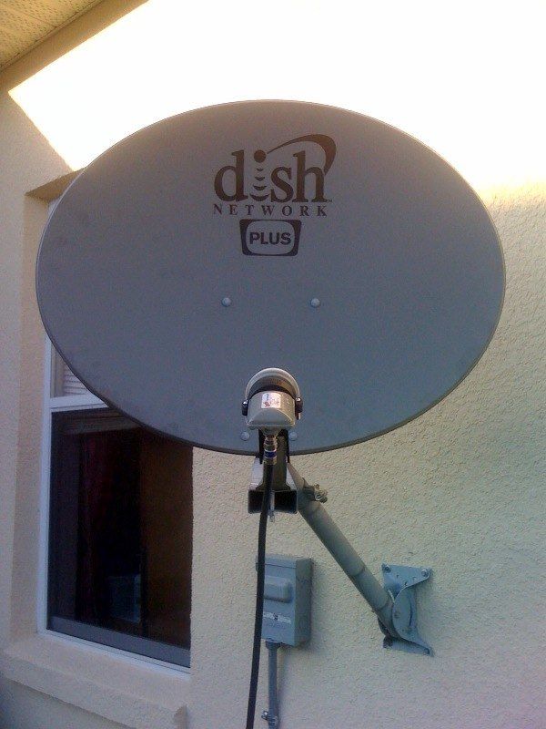

Hi all, I finally got my equipment and I am ready to start looking for satellites.
All high quality coax has been run and dish is mounted and Viewsat Ultra is on and ready to go.
Here is my exact setup:
Viewsat Ultra running factory bin file
Extreme II Linear LNB with 0.3db noise rating
Quality RG6 cable
Dish Network Plus Dish measuring 30 inches wide and 24 inches tall

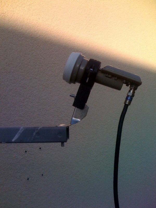

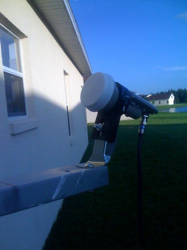

a generic bracket mount from ebay allowing me to mount the ExtremeII LNB on the arm of the Dish Network Superdish.
What is the satellite with the strongest signal and easiest to aim at from Florida zip code 34741 ? I tried for about 45 minutes nonstop to find Galaxy 19 with no luck at all. My signal is 75 and my quality stays at 0 no matter how hard I tried to find it using the data from dishpointer.com
I have attached some pictures of my dish setup here :
http://207.36.201.8/~op/temp/photo1.jpg
http://207.36.201.8/~op/temp/photo2.jpg
http://207.36.201.8/~op/temp/photo3.jpg
http://207.36.201.8/~op/temp/photo4.jpg
Any input is appreciated. I am not 100% certain I mounted the LNB correctly to the dish with the generic bracket. How does it look from the pics? Should I slightly adjust/bend the LNB mount so that the LNB will be pretty much pointing directly plum into the middle of the dish?

Did you remember to skew the LNB?
From your zip code your longitude is: 81.4°W
I would first try a satellite close to that location. (74°, 79°, 83°)
Where you want the LNBF to be located is at the focus of the parabola (dish).
If you have the original LNBF for the dish, that will tell you where to put the new LNBF.
The face of the new one should be postioned where the face of the old one was.
yeah, it looks like your lnb is positioned wrong
g19 has some pretty hot transponders, so if you are having problems with it, your lnb probably is not on the focal point of the dish, or it is not skewed properly.

I have no idea how you reset the dish after the pics showed.
But from the pic, your LNBs point it too high to the dish, it should point to below the two screw line on the dish, the older type LNBF we can move it farter or closer to the dish to adjust the focal point, you need not to skew the whole dish, just the LNBF. Normally set it to 7 to 1 or 8 to 2 o'clock or 4 to 10 or 5 to 11 o'clock position depending east or west coast you are at for the satellite.
