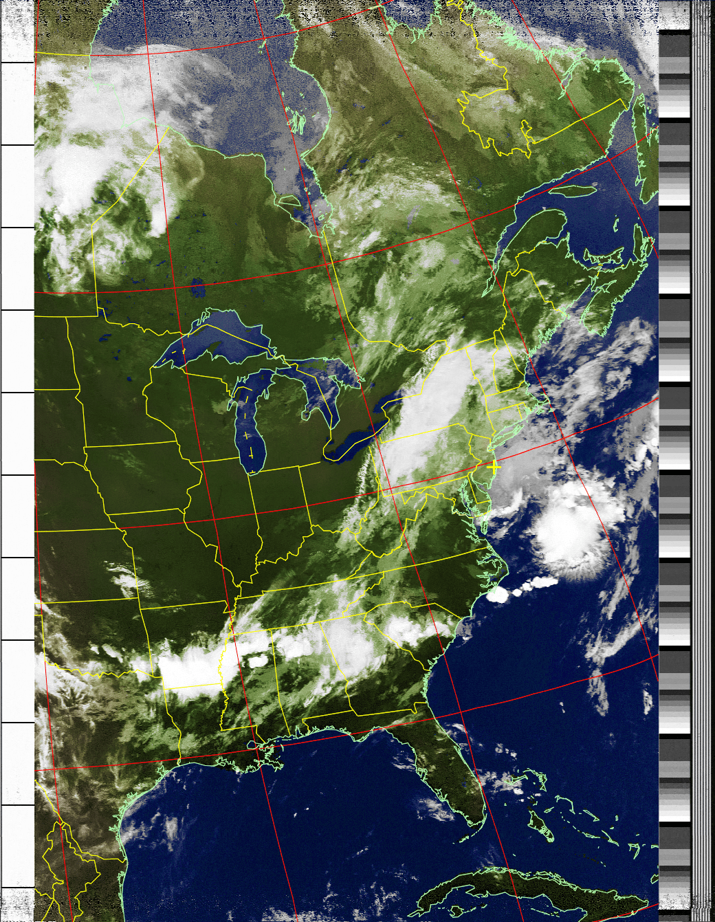

NOAA 15 made a pass overhead around 6:45 am, got this view of East coast from the bird. Nice and clear, clouds are offshore.

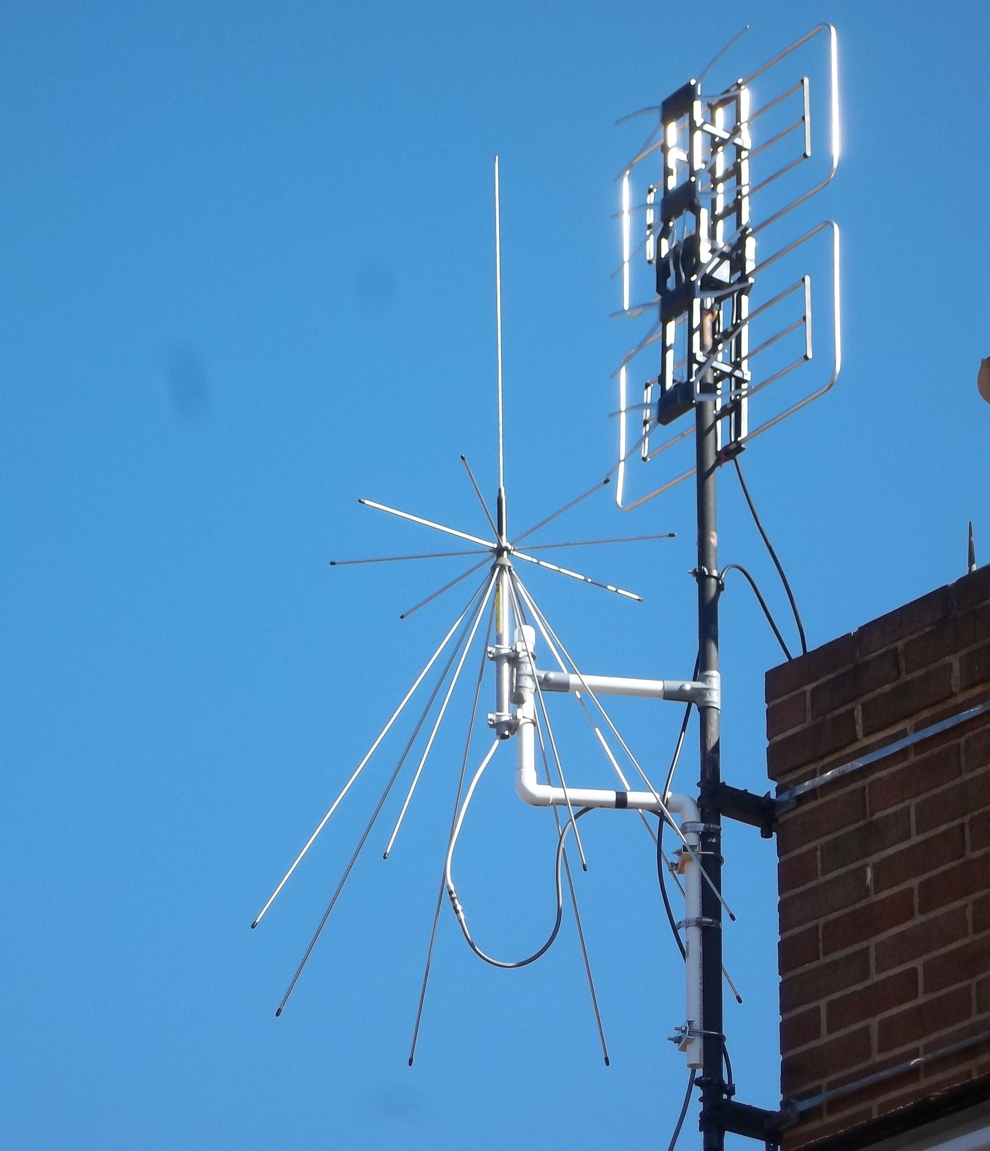

Hi fred555, just using an old Radio Shack discone antenna mounted on the chimney.

Excellent because that's exactly what I have. I need to mount it on my workshop soon.

I'm good to go because that is my exact setup. I just need to mount the antenna, outside, on my workshop.

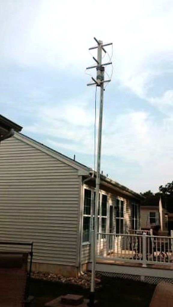

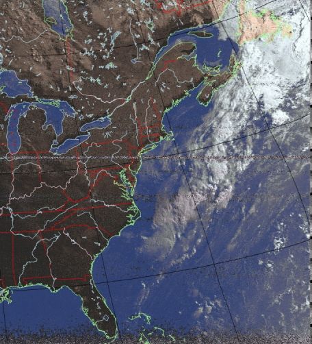

Spent time today checking out the best Antenna for NOAA satellites. I have a 2 Meter J-pole on the roof, an in the attic Diamond Discone and an home brew Quadfilar antenna, that I set up in the back yard as needed. So far The Quadfilar works the best.
