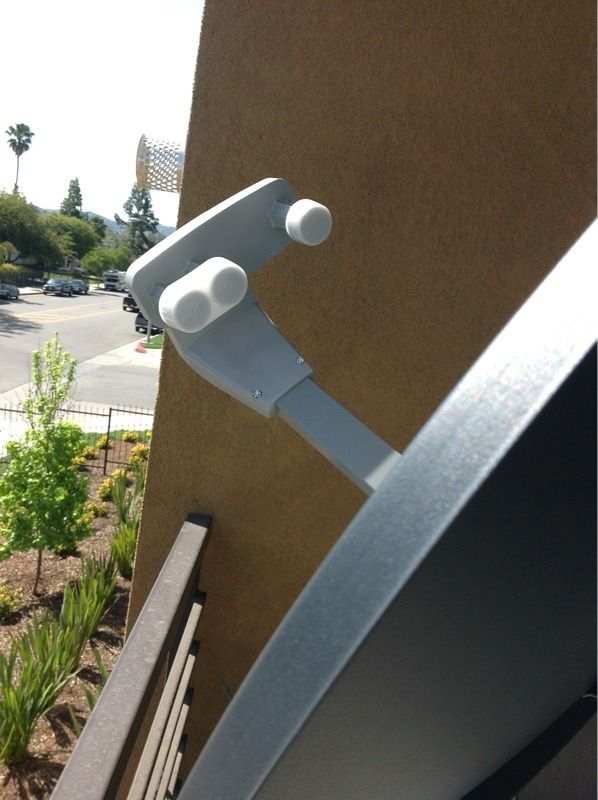

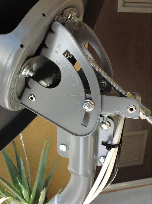

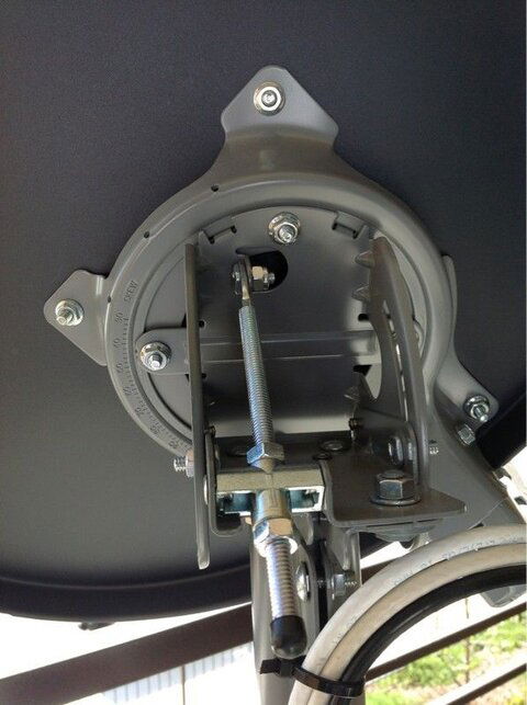

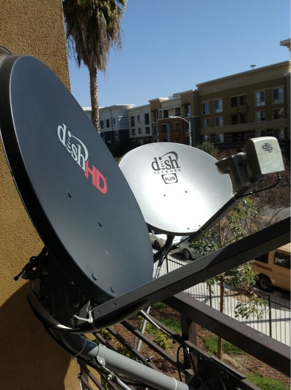

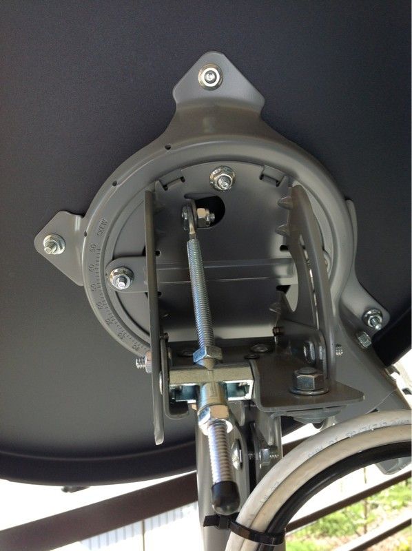

My eastern arc installation in Los Angeles along with skew pictures. Hope this helps

Thanks for the info, very nice pictures btw. I don't think those specs will help me much as I'm in the eastern part of canada. But if your getting good signal strengths in la I should have no problem here. But not working quite right at the moment.
