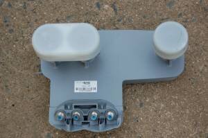

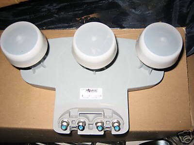

Does your current LNB look like this: 8306_11.jpg
Or like this:31d50_5Nf5H35M53I43Fd3Jec2m7bd26dc5905113de.jpg
The first one is a 1000.2 WA LNB and should never have been pointed at the EA, it was not designed for that. The second is a 1000.4 EA LNB and is what you should have. If you have this it also means you already have a 1000.4 dish, and you just ordered the same thing you already have.
Interesting find. My lnb does look like View attachment 74789

That's an EA lnb for a 1000.4 dish. 1000.2 was never for EA.

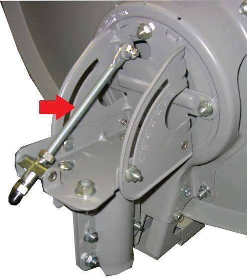

Does the back of your dish have this long adjustment screw?
If so, then you already have a 1000.4 If not, then you have a 1000.2 to which someone has attached a 1000.4 EA LNB, which was never meant to work. I have come across installs like this before, and they always have low signals because the LNB always ends up shifting since it was never designed to work together.

Mine does not have the long adjustment screw. It is the 1000.2. This gets me to understand why he could get nothing on 77. But then again I'm in Los Angeles which is not meant for the west coast.
