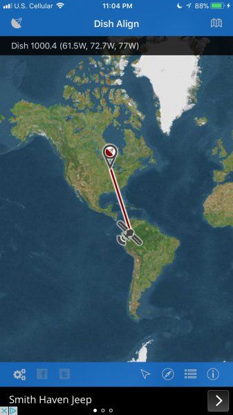

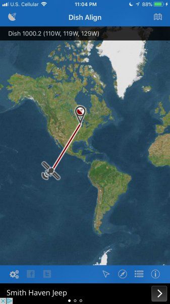

Why does dish use two different arcs when both are visible from the USA?
All satellites on each arc are NOT visible in the entire US. A good portion of the Country can not see 129 or see it well enough due to low height. I can't see it at all in Ct due to terrain. Reason #2 it allows not needing all the locals taking up space on one ARC. Reason #3 rain fade is greater so in Tampa as an example you will have less rain fade with WA than EA. Reason #4 though I cut down trees to get it, I barely see the WA (and as mentioned not 129 at all) but easily see the EA partly because the EA is higher in the sky. Reason #5 where snow falls because the angle of the DISH is not as high, with the WA you get less snow build up. Reason #6 neither Alaska or Hawaii can see the EA.
So each has it's pluses and minuses and it allows more people to get the service.

Also looking with dish align all the D* sats used here are in that area. My grandparents next door have D* and are pointed right about there and have perfect signal. It just odd that there wouldn't be some kind of option then. When I had dish installed I had a post already mounted for a dish from D* in '07 and he said he couldn't use it. But based on dish align he could have used a 1000.2 and just mounted it there and have saved us the stress and time having our lawn dug up twice just to have it set up properly.

As far as the EA vs WA question goes, in mid-country both arcs may be pretty equally visible, but that does not apply to the entire country. Where we are right now in upstate NY for instance, the lowest WA sat, 129, is at a 16 degree elevation, while the lowest EA bird, 61.5, is at 38 degrees. That's a huge difference when there's trees around...
