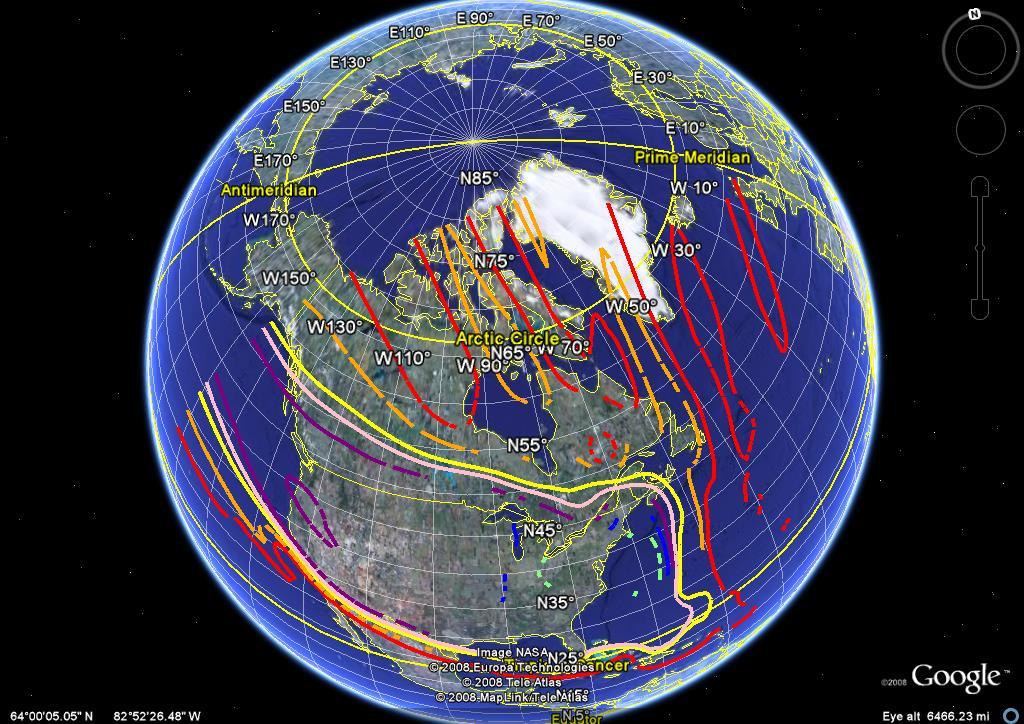

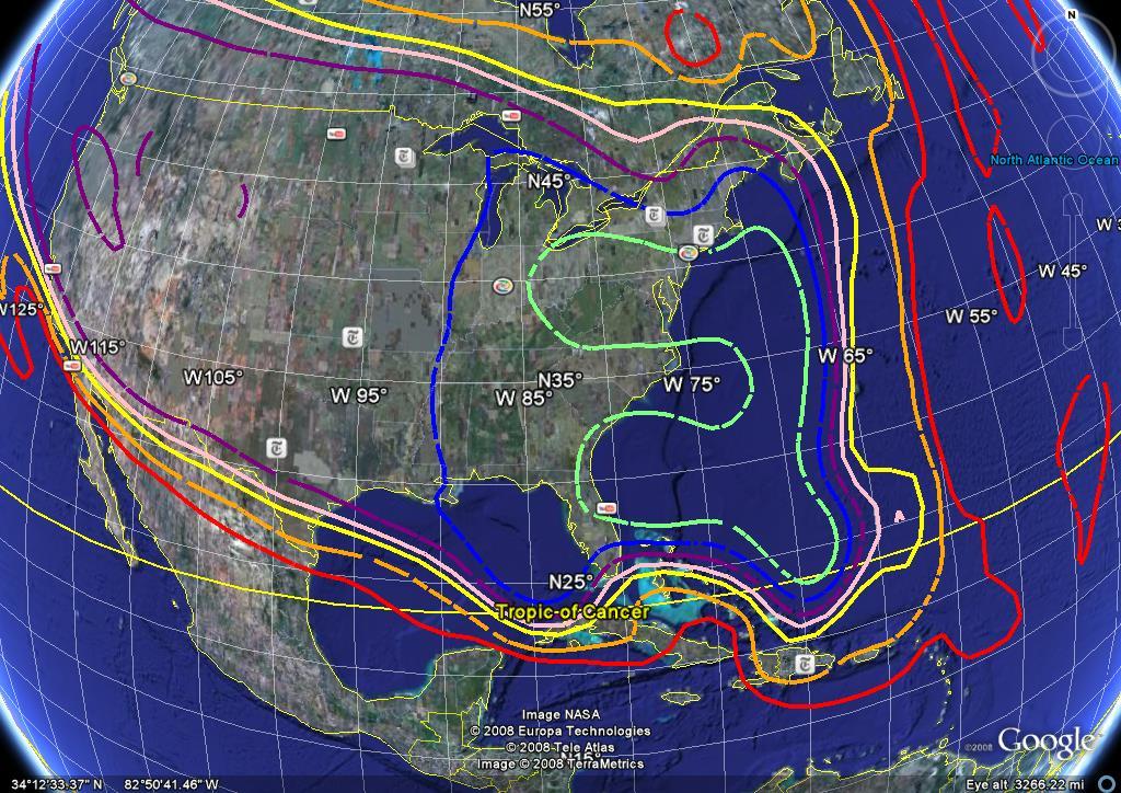

Echostar 6 at 72.7W - Medium Power Level
Green = 52.66 dBW
Blue = 50.66 dBW
Purple = 48.66 dBW
Pink = 46.66 dBW
Yellow = 44.66 dBW
Orange = 39.66 dBW
Red = 34.66 dBW

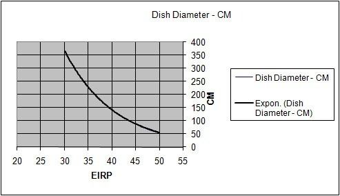

See attachments for footprints and Dish Diameter Vs dBw.
Well... looks like those in the Virginias, Maryland, PA and Eastern Ohio can place their microwave popcorn directly on the dish aimed at 72.7 and have it pop juuuuuust right!

So I take that to mean that those living like in Texas are NOT in prime location to receive a great signal from the eastern arc? I installed my eastern arc dish a couple of days ago to see what I could get and I get at best 45-48 on the 72.7 satellite. I tried different elevations than what was suggested in the installation manual. It only worked on what was suggested for my area. I didn't try to change the skew though. Scott G. in Conneticut and some member from New York said that they are getting from 55-62 signals on the 72.7 sat from there locations. I am wondering if the numbers go down as you move further south and west from the perscribed area for eastern arc? I know that Houston locals were on the 61.5 sat for months, but unavailable and they took them off recently. I wonder if they decided that Houston, which is 90 miles west of my location , was to far west for great reception for the eastern arc dish?
Should get decent reception with a 20 inch dish at your Netherland location.
E6 was not designed for 72W so what one sees is a temporary fix until the new Nimiq 5 launches. The Canadians do a great job with their footprint designs (ie Anik F3) and I will speculate that Nimiq 5 will cover a much larger service area with it's stronger BSS service.
Well I think that 45 - 48 signals on the 1000.4 is comparable to the 45 -55 signals I get off of 119 on the 1000.2 sat dish. I just wondered if the reason why I am not getting 55-62 like Scott G. and others up north in Connecticut and New York, may be because of the satellite foot print having less coverage down south in Texas.
You are absolutely correct.
Thanks then. I won't worry about it then. I can't really use eastern arc anyway till I get the new smart cards. When I do receive them , I might just run my main tv on eastern arc and my other two on the western arc to see if I see any real rain fade problems or differences.

they need to adjust that a bit so the peak hits south florida..
I don't think it's doable, otherwise I"m sure DISH would correct the footprint.
The satellite was designed for more middle-of the North American arc service and if the footprint designed for that slot is fixed, then the footprint shifts eastward when you move the sat east. It's funny how the Florida part of the footprint when E6 was mid-arc is now out over the Atlantic a ways.
