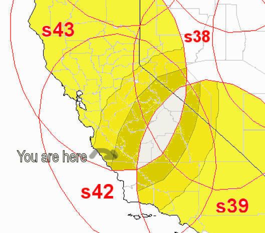

Hi all,
I noticed this last weekend that I could not get some stations that I had been able to get a week earlier.
In particular, all the "minor" San Francisco DMA stations seem to now be on transponder 31 spotbeam 43 (thanks Tony and dishchannelchart for the info) and I am unable to get any of them. Admittedly, I am on the edge of the SF DMA and the spotbeam signal strength has always been a bit weak, but a zero signal strength seems even weaker. Interestingly enough, I get "good enough" signal strength on the major stations which are on transponder 26 spotbeam 43.
So, my question is this ... what should I do to fix this?
I could go up and start re-aiming the dish (dish 500) to optimize for the weak spotbeam (if I can get it at all).
Could it possibly be that my (legacy) LNB has somehow gone bad on transpotter 31? I didn't notice any problems earlier, but then again, pehaps I hadn't been using that one earlier.
One nice think is that I've got a spare Dish (dish 300 ... which was aimed at 148 for those same locals) and a spare LNB for testing if need be. Would a dish 300 be more effective than the 500 in these borderline cases?
Any ideas would be much appreciated.
