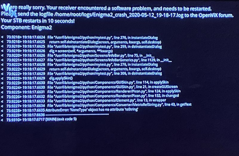

I've finally been able to access the internet via wifi, with my stb.
I downloaded a few Open Vix skins via webif to check for variety.
In downloading one then trying it out, I encountered a repeated rebooting issue.
How do I fix this issue ??
I'm enclosing a picture of the rebooting screen.
Thanks in advance.
John
Have you got puTTy and filezilla?
Might can fix by init 4 (stop enigma) with puTTy
Then with filezilla download and edit the settings file in etc/enigm2
Look for config.skin line(s) in the settings file and remove the line(s).
puTTy init 3 (restart enigma).

Did you have other images in other slots?
You can use the blue recovery screen to boot another slot.
Power cycle or while the box is rebooting as soon as you see the Edision splash screen press menu button on the remote.

Yes, you will start with a fresh slate if you overwrite slot one with a new image and have no back-up folder on any attached drive.
Many skins are old builds, not well implemented or not updated regularly. You should report this error on the OpenVIX forum to alert other OpenVIX image users. Exploring skins can be quite risky and time consuming if you don't understand how to recover as was outlined above.
May I suggest that this would be a great time to transition away from using OpenVIX in Slot one and instead try the TNAP 3.2 image as the default? Much less chance of defective skins and plugins as the online TNAP updates are continually sorted and refined. El Bandido is doing a great job at coordinating the user tested files and maintaining the distribution.

I just tried loading the current OpenVix image to start (which I had been running) and after booting, the screen goes to 100 for a second or two showing the OpenVix screen then backs down to 95 and returns to the rebooting screen from the defective skin.

You had previously tried installing the original TNAP v1 (modded SatDreamGR image). TNAP 3.2 is a completely different build and is now updated on-line.
Are you attempting to install a new image to slot one (emmc image with "force" file in folder) or rebooting to the currently installed image? To start fresh, install a new emmc image in slot one and don't have a back-up folder on any attached drive.
Reactions: JFOK
To perform a clean install in slot #1:
* Unzip and place an emmc image on top level of the USB thumb drive
* Open the folder
* Change the file "noforce" to "force"
* Unplug the OS Mio 4K
* Remove any other drives
* Insert the thumb drive
* Plug-in the OS Mio 4K
* After the update completes and the STB reboots, remove the thumb drive and configure the STB with the startup menu.
Delete the folder from the thumb drive to prevent accidental image overwrite.

I followed your directions exactly while trying install TNAP 3.2 into my stb.
It booted up to 49 on the first try then the OpenVIX image appeared and the rebooting screen appeared.
I tried a second time and it booted to 100 then it backed down to 95 and that reboot screen appeared. :(
John
** UPDATE**
After deleting the TNAP 3.2 from the usb key and reloading it, I attempted another flash. This time it worked. Dont know what the issue was with the first installation, but all is well now and I'm setting up my stb using TNAP 3.2.
Thanks to Brian and SDA_Fl_USA, Your assistance was GREATLY appreciated.

John, Did you download the USB.zip?
Seems the Mio4k didn't flash an image at all.
You will see a white screen come up saying something like software upgrade and the file name. After the flash finishes and reboots remove the thumb drive.
