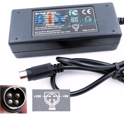

OK, looks like they are using easier connectors/supplies now.
This i what I've seen in the past
