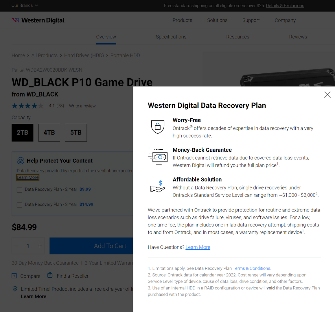

You could go with this one.
Amazon product ASIN B06VVS7S94
View: https://www.amazon.com/Western-Digital-Elements-Portable-External/dp/B06VVS7S94/ref=sr_1_5?crid=K3NAFOTKHUEL&keywords=1tb+external+hard+drive&qid=1695601371&sprefix=1tb+%2Caps%2C157&sr=8-5&ufe=app_do%3Aamzn1.fos.006c50ae-5d4c-4777-9bc0-4513d670b6bc Mine is the powered version of WD Elements that may not be available any longer. I bought mine in 2010 and it has been rock solid all these years. The Hopper may very well be fine with using the simple USB power. Many here are using non powered EHDs with no issue. If you are uncomfortable with that all you need to do is add a powered USB hub into the mix and it works fine.

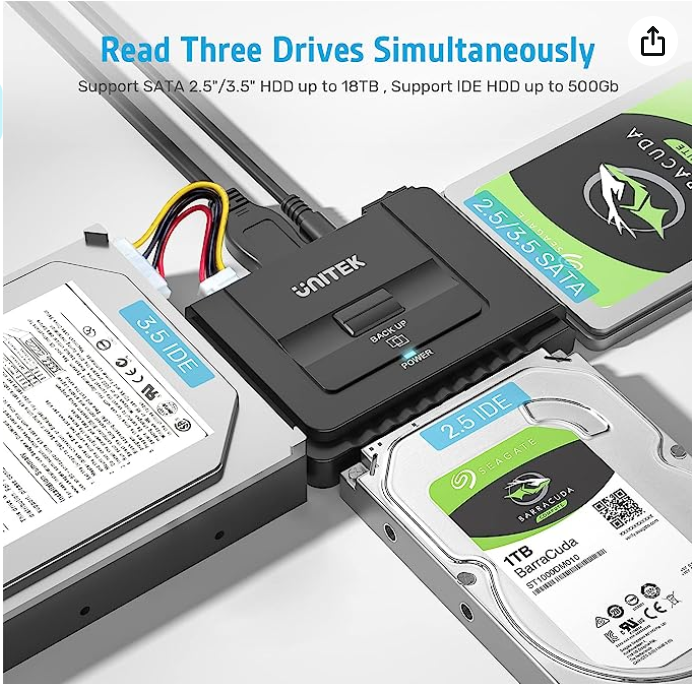

1) The reason it doesn't recognize most likely isn't the hard drive itself but the ATA to USB bridge or controller chip that sits between the actual internal HDD and the USB connector as I had the same issue with a docking station
which worked on the Hopper 1 and not the Hopper 3. When I changed to a USB to PATA/SATA Coverter cable, the same HDD worked fine. I still had the Hopper 1 at that time to transfer the recordings to the Hopper 3 before shipping
the Hopper 1 back using their shipping pre-paid box. So you actually won't know in advance you won't have the same problem until you actually try it which is the only accurate way to know. So even a external drive, you basically
would need to take the drive out and use a enclosure, dock station or USB to SATA connector cable that works.
2) It might or might not since even your obscure brands will still use a drive inside from one of the few remaining drive manufacturers which includes Seagate, Hitachi, WD, Toshiba, Fujitsu but like mentioned in #1, the other
variable is they need to use a ATA to USB Bridge that is compatible which you won't know until you tried as even WD or Seagate can change what they use for a ATA to USB bridge. As for brands, each brand can be good or bad because it all depends if that brand has a bad product during that time or not like in 1997-1998, one would avoid Maxtors because of the high failure rate while in the 2000s, Maxtor was cheaper than the other brands but they have another problem, they have lower tolerance than other brands as they ran hotter than other brands so the failure rate was also high. Western Digital also had failures during a time period recently where there was a high failure rate. And IBM now Hitachi for example in 2001, where their DeskStar 75GXP which came in different capacities where every drive will eventually die from a click of death issue giving them the nickname of DeathStar. I noticed that Western Digital, not sure of others, they now sell data recovery protection when you buy a HD from them like this for example, the Black is supposed to using a extremely fast internal drive from their Black series...
And I wanted to add, that for the Elements, My Passport, My Passport Ultra of the same product year, they will all use the same exact internal HDD inside. The only difference is the Ultra has cloud backup so you are paying for external features. They will all have the same 256-bit AES hardware encryption. The portable model called the Black is probably faster as it appears to be based on the Black version of the internal drive with the same capacity as far as WD is concerned. I have 2016 purchased My Passport Ultra 2TB EHDDs which only talks about Windows 8 on the box and I have one from last week which is named exactly the same but a newer model. The difference is the former and I have 6 different ones takes 5+ minutes after plugged in or the Hopper rebooting before it will say it's connected after watching the HDD enclosure light flash accessing it while the new one takes 1-2 seconds. All of them are self-powered but plugged into a Radio Shack USB 3.x hub which is powered.
This is my go to enclosure, it doesn't require external power. I buy new take outs of 500 gb laptop hard drives on ebay. Works like a charm in multiple installs.
Amazon product ASIN B0B2D1ZKD8
View: https://www.amazon.com/gp/product/B0B2D1ZKD8/ref=ppx_yo_dt_b_search_asin_title?ie=UTF8&th=1
