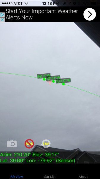

So I had two technicians come out to install my service yesterday and today. I'm in an apartment so the dish would be installed on the balcony, and both said "oh you're not going to get signal, your balcony wall is blocking the satellite path" My understanding (and every dish pointing website available, including DirecTV's dish pointer) is that the satellites are around 211ºSW with a 39º elevation. Techs were checking around 250ºW for the satellites. Asked the tech today why/where he's looking for the sats, he said "oh I'm right" went and grabbed a compass from the truck and still pointed at 250ºW and said "yup you can't get service" I attached a screenshot of one of the many sat finder apps I used to try and show the tech he was wrong, and you can clearly see all three sats with a relatively clear path. Any ideas what's going on?

The sat finder apps are not always accurate.
But likely the tech did not want to do the install.

250 degrees azimuth has to be WAY off. That's nearly due west.
raoul5788
raoul5788
Studebaker driver
Staff member
HERE TO HELP YOU!
Dec 28, 2004
31,315
15,051
Cheshire CT
That was the knucklehead tech that said 250 degrees. The picture he posted says 210 degrees.

I'm gonna say its gonna be closer to about the same as Boston would be.
210-220 ish sounds about right.

The location is Morgantown WV, check the TSs avatar.
