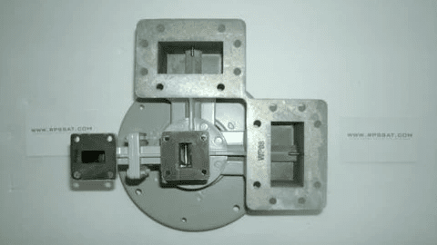

I guarantee you NOT getting every TP's on 58w I don't care how so call tight which there is NO SUCH TERM in dual polarity C and Ku dish. Just think why do you think they made a device to rase or lower your elevations.
My ADL quadfeed gets both h and v on both c and ku band.
I tell what to do google the term "dual polarity feed horns" and see how wrong you are. Next google the term "dish is tight" and let us know geez.
:oops:Here is the ADL feedhorn that does the same thing as a chaparall bullseye !! Also I have both ADL c band dual polarity and Chaparall feedhorns. When I googled dish is tight, a picture of a dish rack full of dinner plates displayed on my screen. Geez

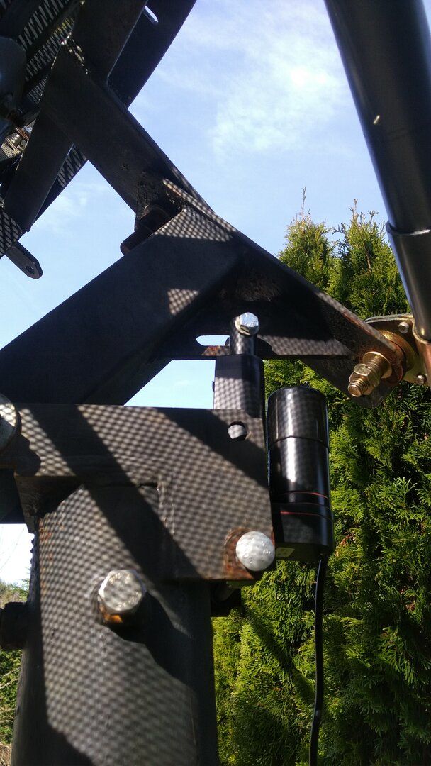

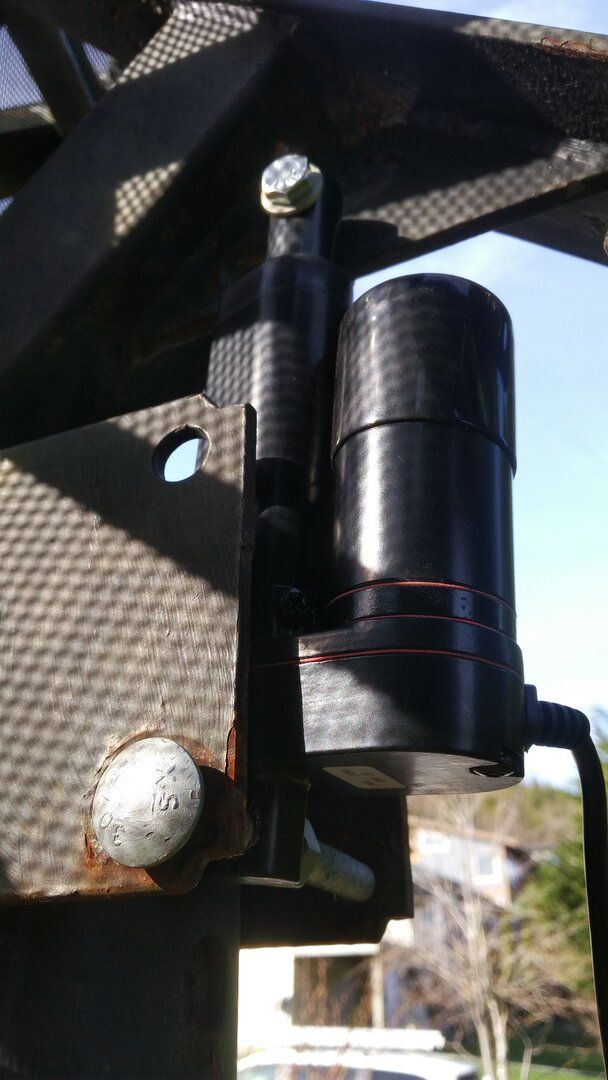

I took another stroll through Windynation and purchased a 6.25" 12v linear actuator with a 2" extension and momentary DPDT switch to add remote elevation adjustment.
It's AWESOME for tweaking those pesky Ku TPs that just need a little bump up or down.
I ran 100ft of direct burial CAT5 and used a 12v 2.67A power supply to power it. Taadaa!View attachment 150855View attachment 150856

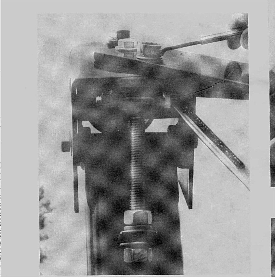

Hey I got mine today to my surprise very well built, a nice heavy duty switch, but unfortunately I don't have enough clearance where my elevation screw is at, the unit is stands about 6 1/2 inches tall, I only have around 4 1/2 inches clearance. I only way I could get it to fit is to cut the elevation mount out and lower it and weld it back, a little to much trouble so I just sent the it back. That is one good thing buying from Amazon returns and no problem.. Not like that clown on the other site selling satellite equipment.
Take a few pictures of the back of the mount and post it here. Perhaps some extra eyes can suggest mounting points. If you have a measuring tape extended to around 7 inches in the picture, it will help give perspective.
I have old Orbitron SX 10 there is only one mount for the elevation screw the only way to fit in there is to cut the mount that holds the elevation screw and lower it and re-weld it.. What I plan to do later is to cut it and weld it back lower the distance between that is only like 4 1/2 for my elevation.
