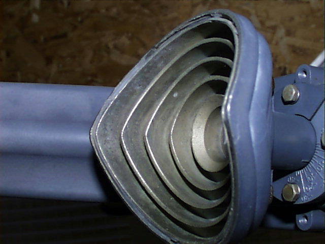

I'm setting up a Primestar 84E C-band dish with the BSC-621 after finding Icebergs thread on topic.
I see that Sadoun is, maybe, going to offer a "Conical" scaler ring.
Here is a pic of Primestar LNB scaler ring for Ku-Band (on right). Also a pic of proposed "Conical" ring (on left).
Should not this new ring have similar geometery? Only scaled up for C-band.

The reason the scaler ring on the primestars Ku feedhorn is shaped like that is it's an oval dish that's very wide and not so tall. That means the F/D ratio effectively changes as you move around the outer edge of the dish. That is it has a different F/D horizontally than it does vertically and in order to properly illuminate it the scaler ring must be design this way as well. So, even the conical scaler ring will not properly illuminate the primestar dish. In fact, in this case, I'm not sure that it will be much better than the flat scaler ring. You can try it and see but in my opinion the conical scaler ring will just be a waste of money for this application and will show little or no benefit. The odd shape of the dish and the fact it needs a special shaped scaler to properly illuminate it combined with the fact that it's way too small for C band will make the scaler ring moot.
A proper scalar ring for the 1.2m Offset dish would be one in between the two you showed above. Basically morph the one on the left to look slightly like the one on the right and you got an optimized version for the 1.2m.
