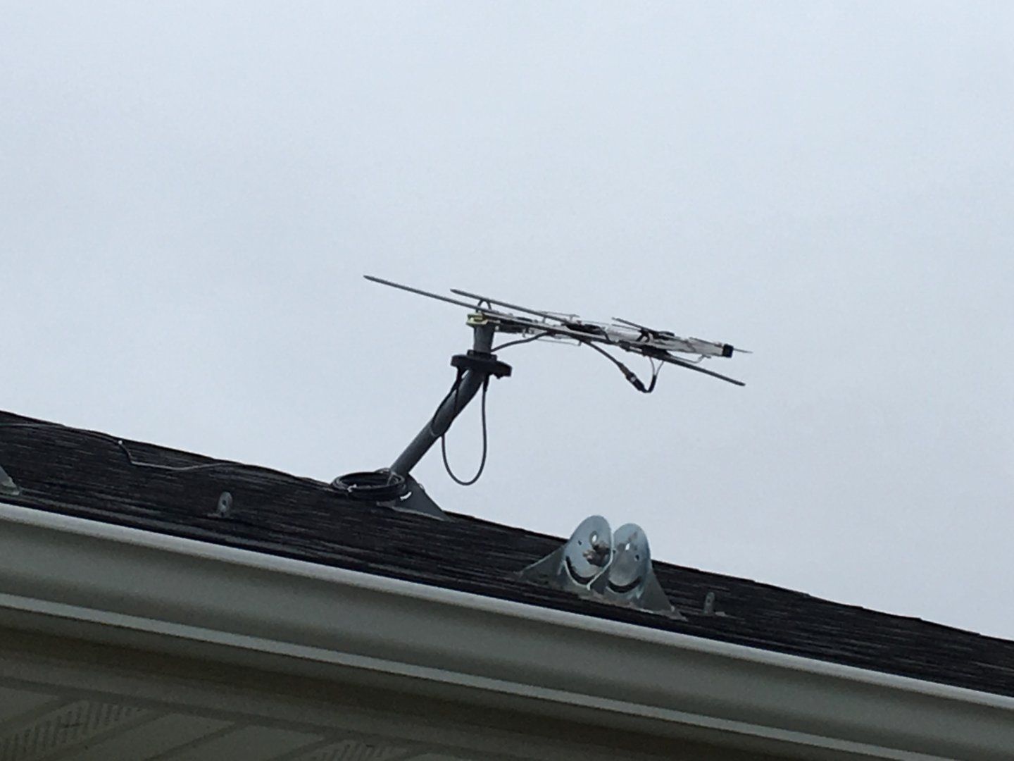

Tilting a terrestrial antenna up/down will usually have little effect. Raising or lowering the antenna height will have a major impact. In some instances, higher is not always better.
While I agree that raising or lowering an antenna will have the greatest effect I must respectfully disagree regarding tilt. I tried mounting the antenna at numerous heights at a number of locations. In our case tilting the antenna upward toward the hill meant the difference between receiving or not receiving many of our channels. All situations are different. TV reception is a mix of proper equipment, location and even a bit of luck. Tilting may or may not help but you never know unless you try. :)
Reactions: norman881
My home is located in a valley. When I had my RCA ANT751R yagi on the roof, I experimented by moving the antenna until I achieved the best signal strength and quality. Tilting it down worked best.
Reactions: FTA4PA
Of course, any change can make the difference especially if there is little headroom. :)
The beam pattern of an antenna design will determine the effectiveness of tilting the antenna. Changing the polarity also can have an effect on reception. One channel at my home (3rd edge) is only received if the antenna is rotated for nearly vertical polarity and nearly 45 degrees off-axis. Obviously it is reflecting off of something (or multiple reflections) to arrive my location.
Lol now you got my gears turning, hiw much of an angle ? Im thing how can i make an adjustable post that i can try alot of angles. Ive lived with the issues of ota being horrible in this area for year's would be funny if something so simple changed that, lol.
The antennas I use have several notches to lock them in at different angles. I used the first notch that tilted it upward but you would need to experiment. No guarantee it will work in your case but it did for us. I hope it does for you. Good luck! :)
Reactions: comfortably_numb
Well, my landlord is less than prob 60 ft from where i live. He had a large yagi on his roof that is easly 2 or 3 times higher than my antenna, he told me his reception was still bad and he don't use it anymore because of it. But i have never seen anyone try the tilt idea in my area, one guy like a mile from me has tower built thats probably about 50 feet hi, for his tv antenna, i dont know the guy to ask if it helps or not. So far i found i do have an extra satellite mast i i could use to mount my antenna to make it very adjustable, but ill lose a good 5 to 6 feet of hight on it. Ill have to climb up on the roof to see if i can get the bottom of the poles bolted together, if i can ill only lose like one foot on it, but i know because ive raised it already, i get about thes signal at that hight. With the sat pole though ill beable to actually move it up down left and right. This is the same one i have. Xtreme Signal HDB8X-NI 8-Bay - Bing images . if that link don't work let me know ill post pics if not. Thanks for the ideas guys im im going to ..maybe try and mount this thing today if i do, rather when i do, ill check back in with the results. Take care all!
Reactions: N5XZS and c-spand
That antenna works best for me but I did have to screw a strip to the bottom to keep the two sections aligned straight across. Some pretty heavy winds here and the thumbscrews just didn't hold tight enough.
