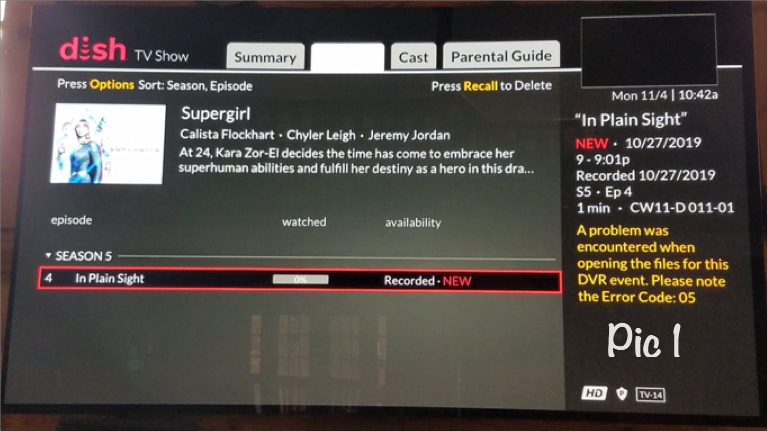

For the 3rd week in a row, my Hopper 3 DVR has failed to record Supergirl on the CW network (Pic 1).The message that is displayed is: A problem was encountered when opening the files for this DVR event. Please note the Error Code: 05. This week I checked TV ACTIVITY several times during this hour and each time it showed a decrease in remaining time and was unpleasantly surprised that when the hour was up, it showed 1 minute was recorded with the above message. I have been able to record the show prior on this same channel with no problem each week.

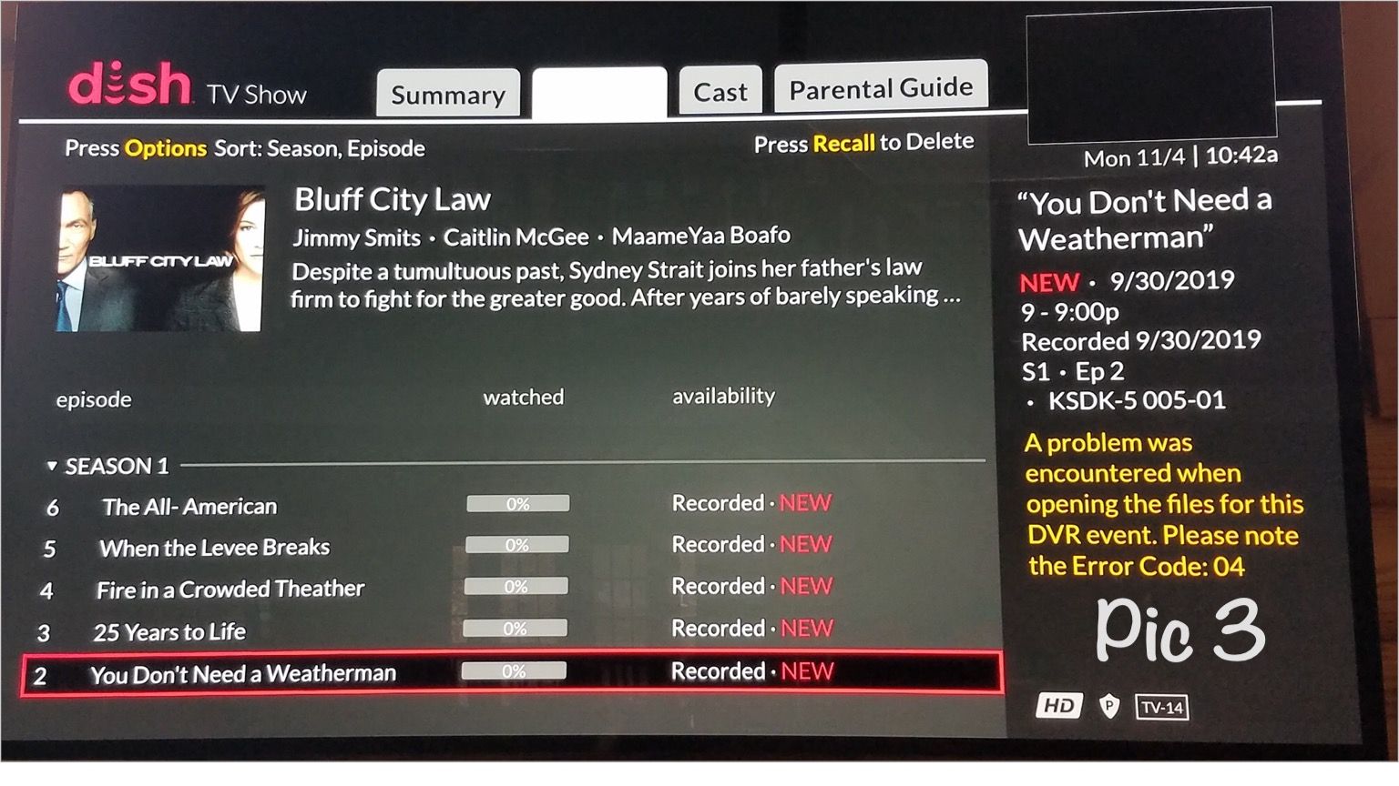

On a 9/30 recording of Bluff City Law on NBC, it showed only 1 minute recorded with the message A problem was encountered when opening the files for this DVR event. Please note the Error Code: 04 (Pic 3) which is the same message as Error Code: 05.

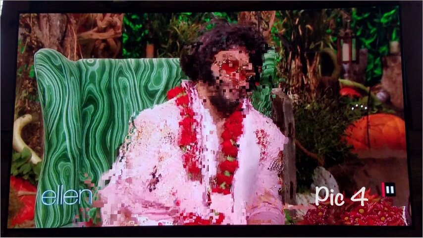

I've also experienced pixelation issues (Pic 4) with my local channels (none on the channels I pay for through Dish Network) but I don't believe it's weather related because this occurs when there is no rain or wind. I read that it might be that the AirTV Dual-Tuner Adapter could have a heat build up, thus creating the pixel issues but we have installed a fan in the entertainment center and no heat build up in the cabinet.
