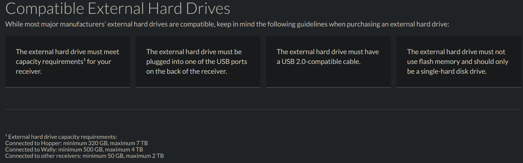

The HD must be a minimum 500GB to work. Your HD is too small.
I think this requirement must be bigger for the 211/Wally than it is for the EHD on a 722. I know I've gotten smallish EHD's to work before. Or else maybe it went up since I was playing long long ago.
Take a look at the attachment in post 5. It clearly lays out the parameters.
Yup; it's less for the Hopper (320GB) and less still for my 722 (50GB), which was what I was playing with. IIRC I was using a 64GB thumb drive, just for grins. Worked great, although the capacity is hopelessly inadequate for the 722, much less a Hopper. And OBTW, an SSD works just fine, as do hardware raid arrays.
