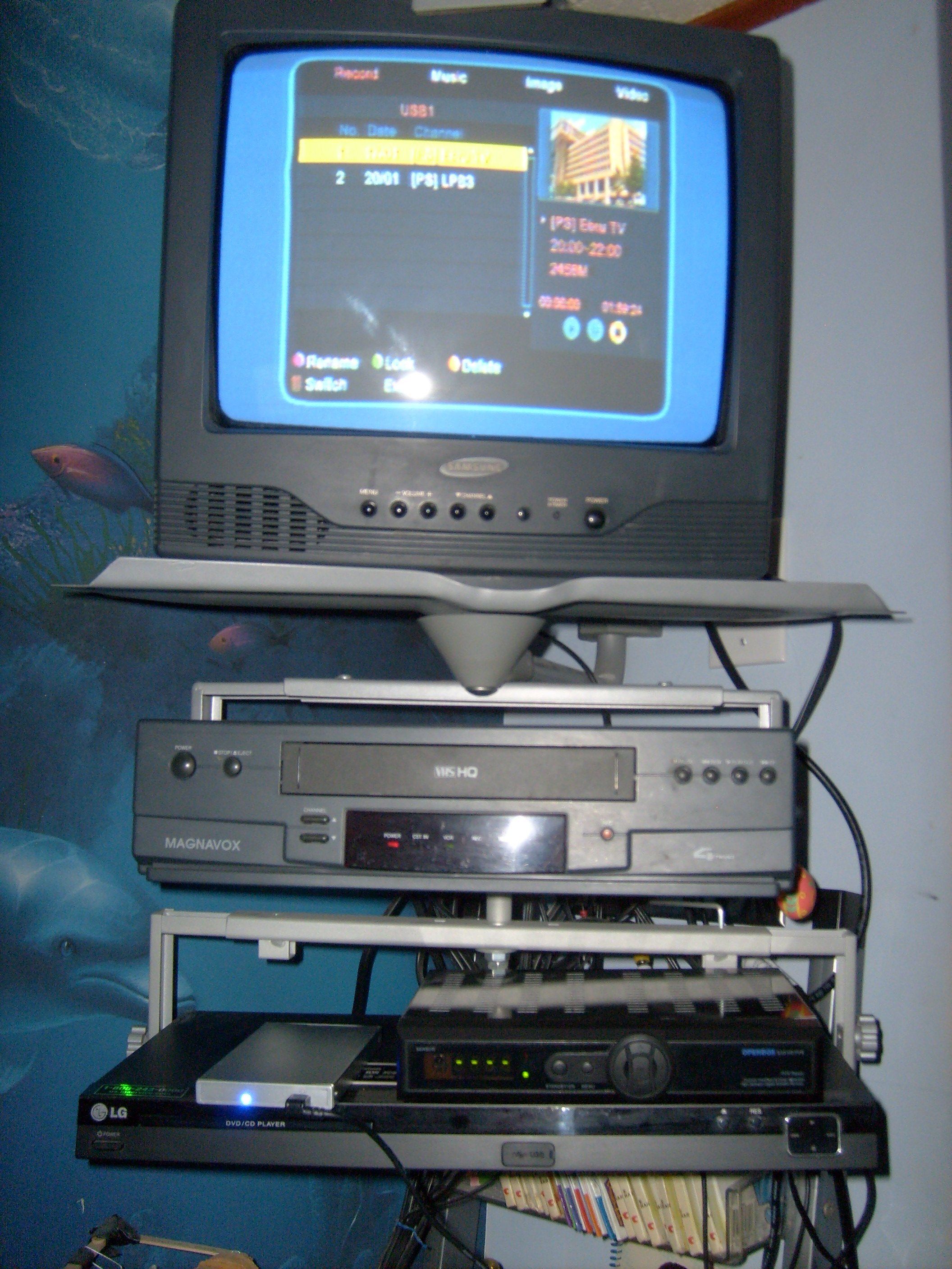

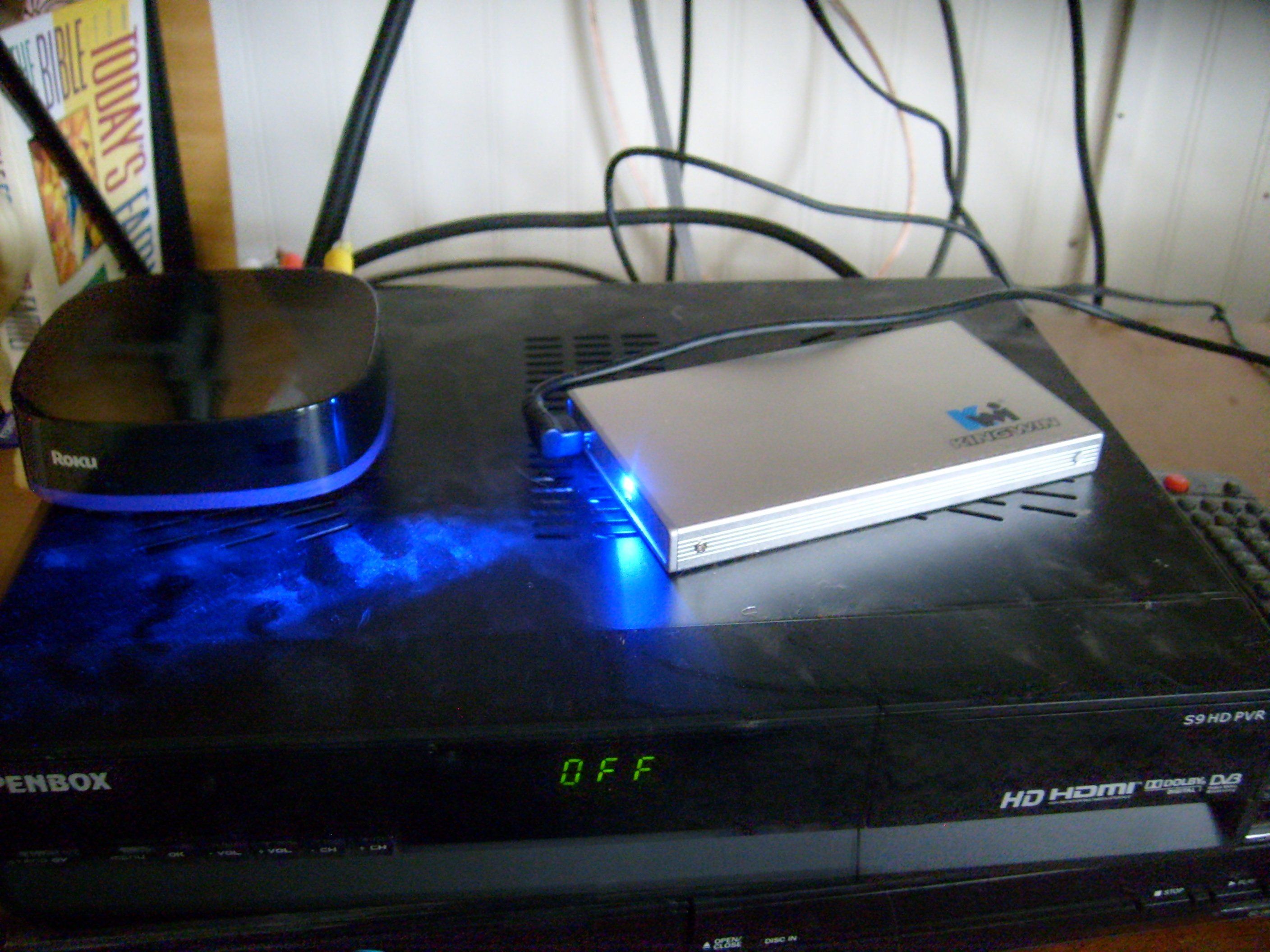

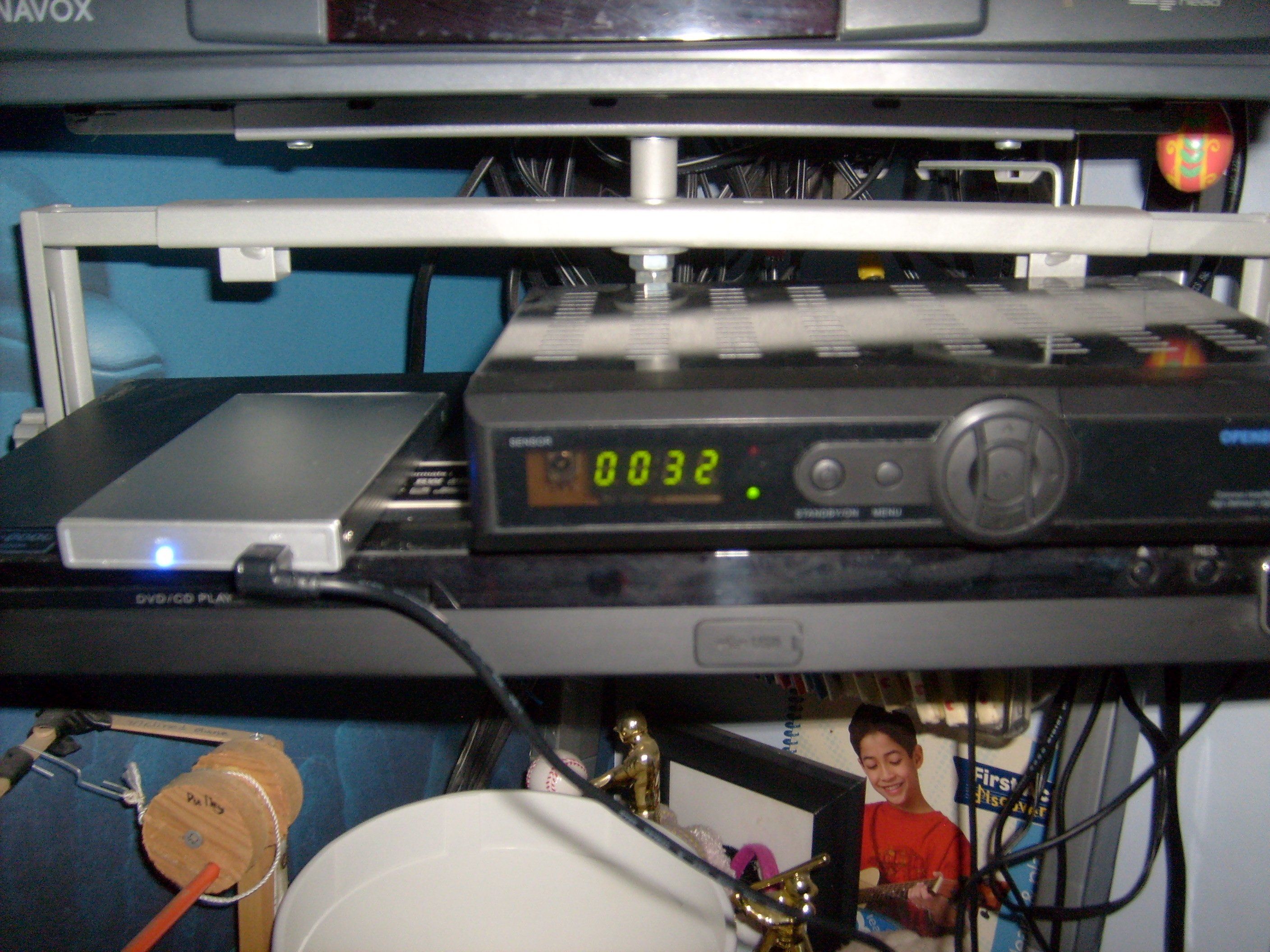

O.K.... I just plugged the hard drive I use for my s9 into the s10. It works perfectly. See pic
