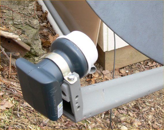

If you have a 40mm neck on the lnbf and you want to keep the plastic housing around it, the old Primestar bracket can be modified fairly easy to hold the lnbf.
See pic.
See pic.
What lnbf is this? I guess what I was asking was, did most people make the clamp themselves or is there a particular one already made that would fit.
That is a Fortec LNB...standard 40mm throat on it

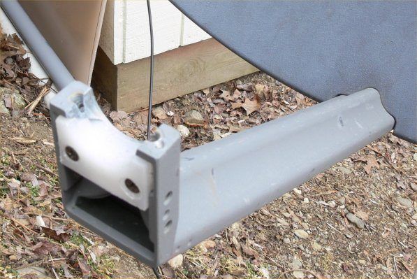

The type of lnbf does not matter, its the diameter of the neck that does.

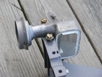

If you strip the plastic housing of the lnb, you will have a 20mm neck that
can be mounted in the Primestar bracket with almost no modification since
the bracket is meant for 20mm.
First pic, this is a dual bracket with a stripped lnbf, brand does not matter.
Second pic shows a Primestar bracket routed out to 40mm, so you can mount your lnbf, with the housing on, I suppose it does offer some weather protection this way.
Ice, the metal hold down is just a piece of band steel with a hole drilled in it.
