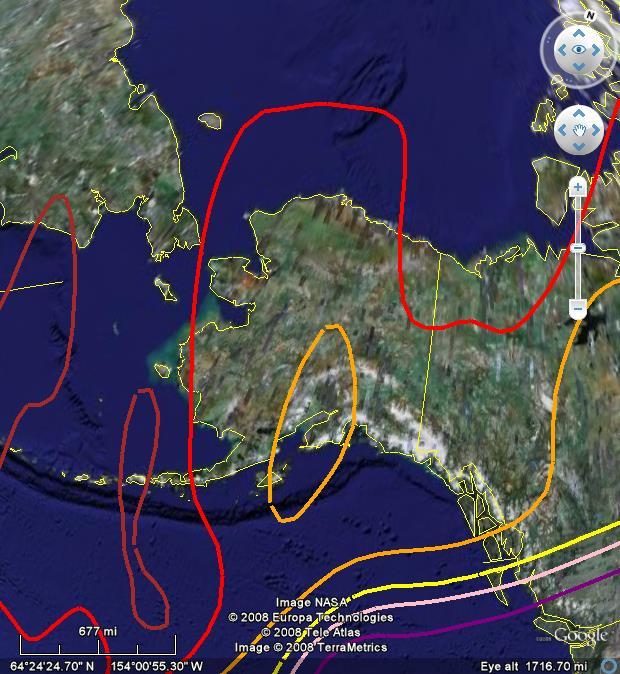

Don't hold your breath for Alaska service from E5 at 148W. With an EIRP range of 34 to 39 for Alaska, it's going to take a 1.5 to 2.4 Meter antenna if it were to provide Alaska service.
