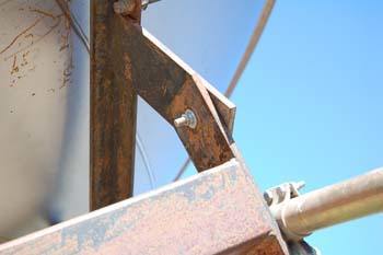

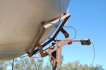

Does any body recognize this style of mounting I’m looking for the proper FASTNERS and WASHERS for this big dish this is a large stainless steel dish

Bill, I posted the pictures as soon as I got them and did not look at them well until I ate dinner. The ones you have marked would best be replaced, if needed, with Stainless steel bolts, nuts and washers of the proper size to fit the holes.I would use vice grips or c-clamps to hold the mount tiight together while unbolting it to measure and put them right back in for safety. Get some anti-sieze from the auto parts store to keep them from binding or seizing. ANYONE ELSE with better ideas?

I agree !! Once Clamped,take one out and run to the Hardware store and get the number of replacement (Bolts,Washers,Lock Washers and Nuts) that you need. Then ,with the one side that is clamped,replace with the new hardware and tighten. Remove clamp,and do the same for the next bolt(s).

The reason for my concern is that the dish pivots on those fastners I'm hoping that some one might have had similer mounting configuration or an installer might have worked with this type of mount

Do we know if there are bushing, or are the bolts serving as the bearing surface?
Either way, I'm thinking grade 8 bolts, with shoulders long enough to keep the threaded section of the bolt out of the shear zone, locking nuts and/or jamb nuts, flat washers at both ends of each bolt, and (if there are no bushing involved) NO lock washers.

Thats the problem I have lost the original Fastners so I don't know.
The 2 flat pieces of .25 plate steel probly should not be directly rubing together. Again I'm hoping that we have some senior BIG DISH installeras on this forum that might know.
