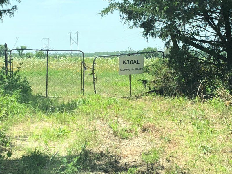

I drove right up to the tower location. Got a solid signal on my RCA rabbit ears (placed on top of my car).

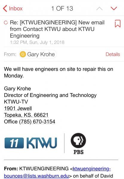

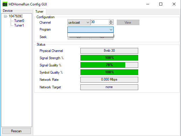

No channel information is displayed. Seems like there might be an error with their transmitter, so I emailed them.

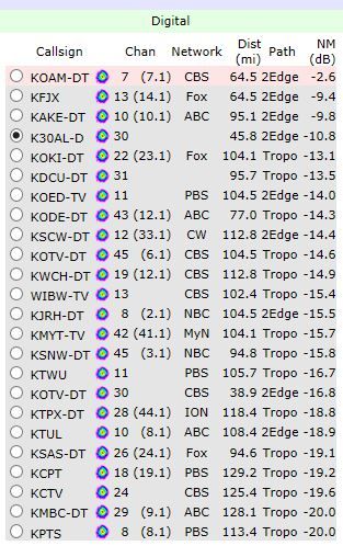

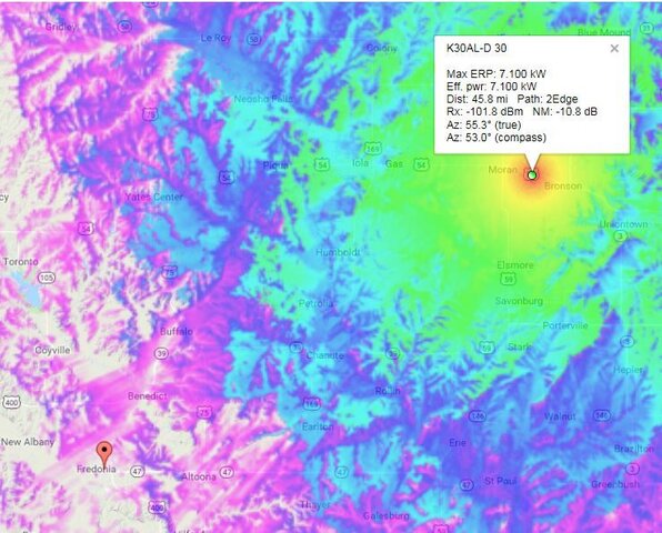

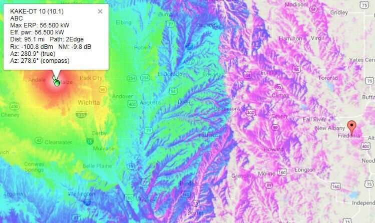

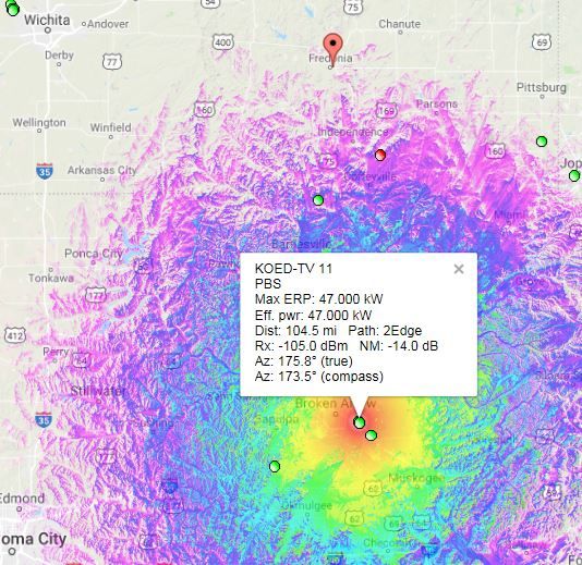

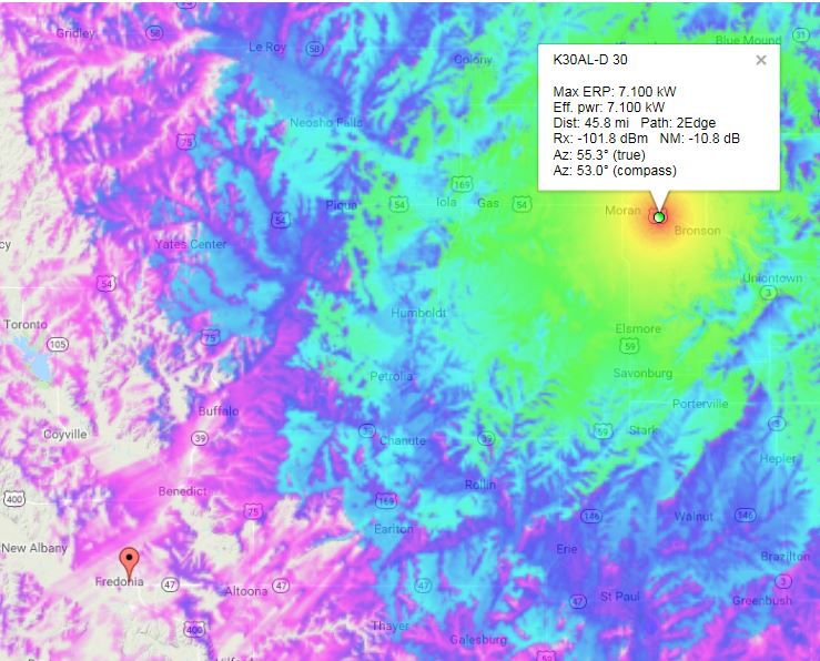

No luck for K30AL here. TV Fool showed there might be a chance for reception, but it's 2-edge at 46 miles and -10.8 dB.

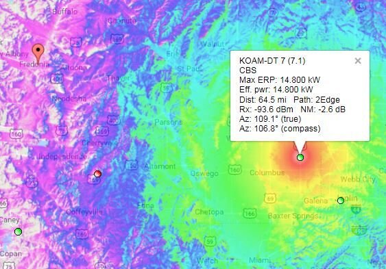

A few snippings of the coverage area here with a modest 25' antenna height.
25-ft.JPG K30AL Snipping_25ft.JPG KAKE-25ft.JPG KOAM-25 ft.JPG KOED-25ft.JPG
