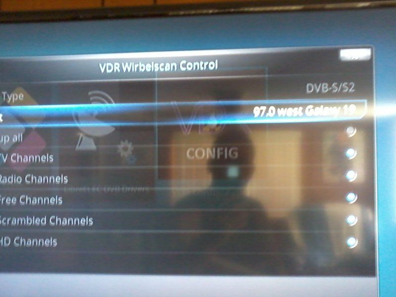

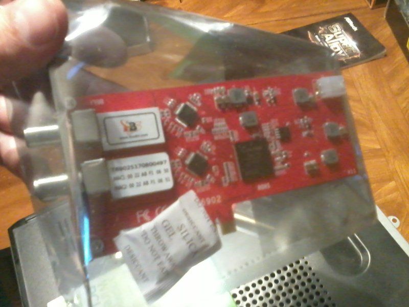

I am finally building the HTPC STB for fta satellite. Its not so cheap to build in the long run, But now I am running into an issue. ........My new build consists of a new motherboard, 1T hard drive, used itx case, stb dvb card, wifi card, and of course a new power supply and heat sink fan combo. I installed libre-elect "kodi" formerly XBMC onto the hard drive.

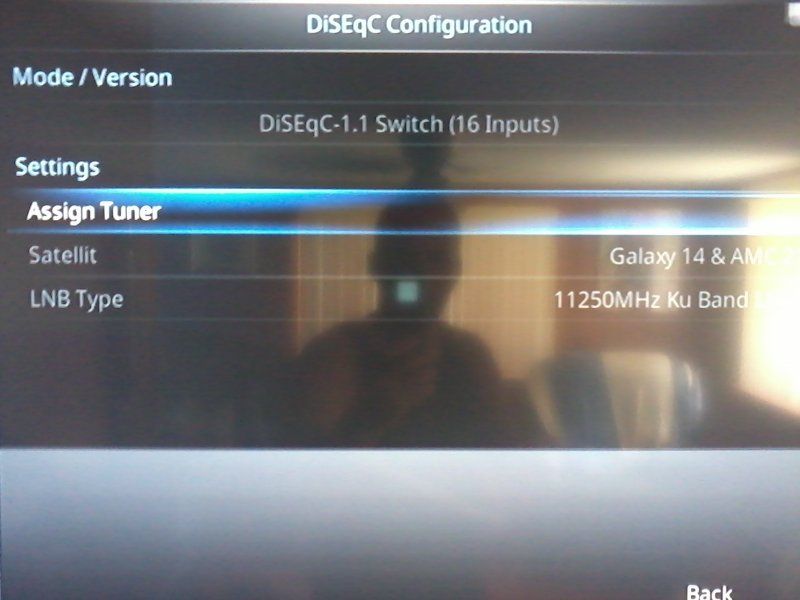

The minor issues that I am having is that when trying to scan for channels, it finds 77 channels for galaxy 19. When I go to the tv menu only 55 are there. and then after changing channels a few times, all channels are the same channel. grrrr.

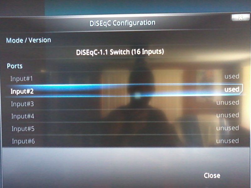

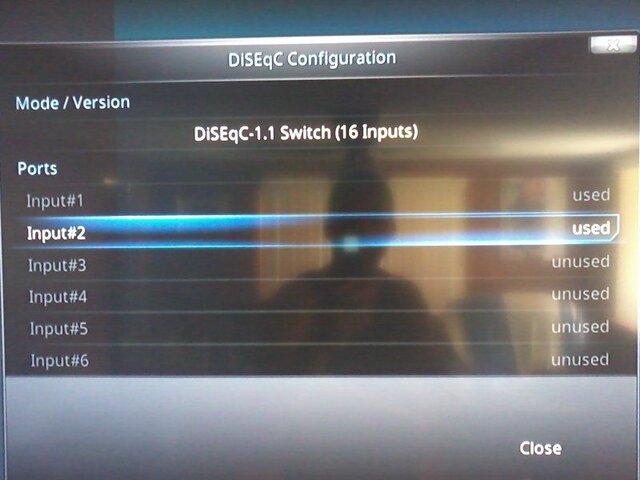

The major issue that i need help with is that in the diseqc settings 1.1 " what my switch is, it only lists 4 port or 16 port switch. Mine is an 8 port. I have done all that I can think of. Selected 4 port or 16 port. Set my ports to 1 and 2 and it only ever picks up on port 1. I cannot scan port 2. I physically went outside and up the ladder to move ports around with no change. NOTE on a normal STB the switch works fine. The add on I am using is called VDR. Only one I found so far that has a familiar menu to set up your "PHYSICAL" "free to air" dish. Or in my case two of them. Photo143.jpg Photo223.jpg Photo224.jpg Photo225.jpg Photo226.jpg Photo228.jpg Photo241.jpg Photo242.jpg Photo243.jpg Photo244.jpg Photo245.jpg Photo331.jpg Photo332.jpg Photo333.jpg Photo334.jpg Photo335.jpg Photo336.jpg Photo337.jpg Photo338.jpg Photo339.jpg

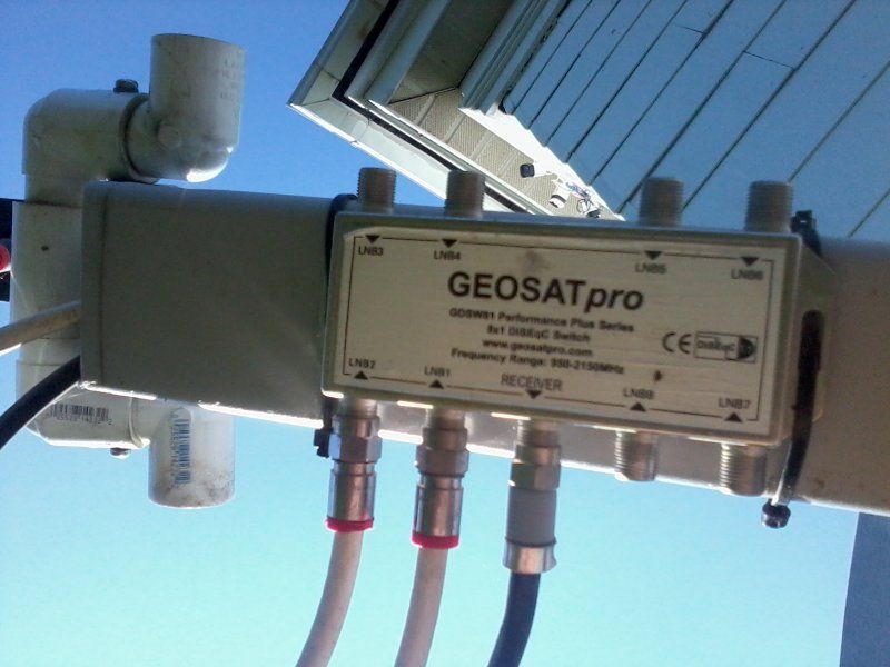

Looking at the pictures, it appears your LO (LNB TYPE) is incorrect. Should be 10750 not 11250 maybe .
... what my switch is, it only lists 4 port or 16 port switch. Mine is an 8 port.
8/1 diseqc switches come in flavours: pure diseqc 1.1; mixed diseqc 1.1/1.0; and even diseqc 1.2.
So what settings are set in your normal STB for this switch?
(1.0 = maximum 4 ports, 1.1 = max 16 ports; 1.0+1.1 combines the two, max 64 ports)
I've got a Axing/HAMA 8/1 switch that switches on diseqc 1.1/1.0/1.2.
As soon as a diseqc 1.2 command is given (I had once forgotten to delete that command in the menu for a certain satellite), the switch doesn't react normally to a diseqc 1.1/1.0 command, alas. The switch has to be reset, to react normally to 1.1/1.0 again.
So it might be important to check the specs of your switch, when you have problems setting it up correctly.
To check if a diseqc signal reaches the switch, try if setting to 'input 16' gives signal from port 8, or from port 5. (That also gives an indication as to which type of switch it is. :) )
greetz,
A33
Reactions: beavs2112
greetz,
A33
OK. so here is a picture of the switch. And like I said before the other stb "geosatpro 3500hd uses this fine. I use two dishes set up with 1.1. One dish on 1.1 on port1 and the other 1.1 port2
That would be a pure 1.1 switch, I find on the internet.
Try input 16 (Edit: try input 2, 4, 8 and 16); does that help?
Otherwise: how much current can your custom STB supply to your switch and LNB?
Do I understand right that you have just two LNBs connected to your switch?
