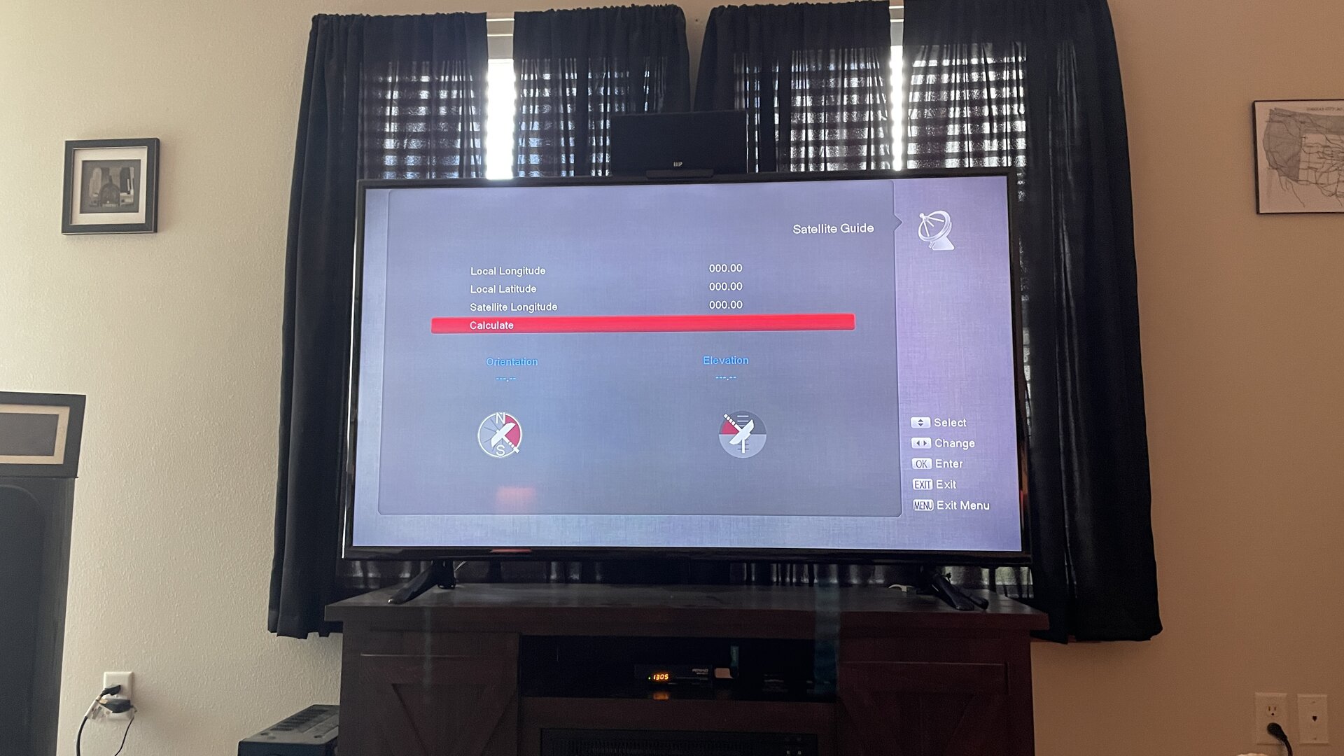

Where do I find the cooridinates required on this screen in the Amiko hd.265?
Not on that screen. Go to satellite setup, down to motor and right or left arrow over to select USALS then hit the OK button and enter your coordinates.
Reactions: comfortably_numb
Go to Google Maps Find your house, and the location of your dish and zoom down on it. RIGHT-click on that location, and your map coordinates will be listed on the top of the info box menu that appears.
Then follow Mikes instructions above to input them.

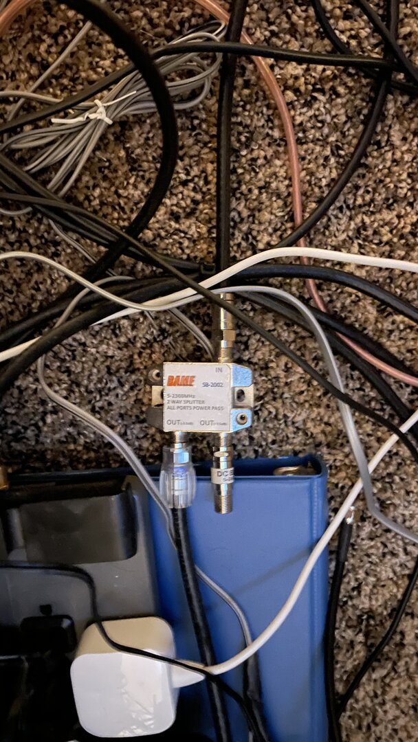

If I want to run 2 receivers off my splitter, do I need to use a DC-pass thru for one of them? Will having LNB power turned on for both receivers fry my LNB? I only want to use the Amiko to drive my motor.
I don't think it would fry the LNBF. But if one receiver outputs 13V and the other output 18V, what would happen to the one sending 13V but being also fed 18V. That could potentially smoke that receiver. Unless the splitter has diodes to avoid feedback.
Instead I would use a splitter that carries DC only on one port, us that port for the receiver that drives the motor and LNBF, and connect the other receiver to the non-DC port, with the understanding that it would be unable to control the polarity and only receive the polarity that the first receiver has selected
Of course you would be much better off with a dual LNBF and 2 cables
"All ports power pass" splitters can be power pass one way (with diodes), or power pass both ways (no diodes).
Alas, that is not always indicated (or not clearly indicated) on the splitter. So I always measure, with a multimeter.
Or I test them by connecting the splitter in the reverse, 'input-out' so to say, and check if there is reception again (NB if the LNB has multiple outputs, these other outputs must NOT be connected to power, while testing the power-through of the splitter!).
All ports power pass one way splitters are good for two receivers, serving one LNB. Alternative would be a smart priority switch (master/slave switch), if you don't want to watch at both receivers simultanuously.
All ports power pass both ways splitters are ideal for having a parallel setup with diseqc devices on one receiver, e.g. having a motor (or VBox) and a diseqc switch at parallel lines.
Greetz,
A33
Edit: From the photo: it looks like comfortably_numb already has a DC-blocker, to implement the suggestion from Brct203 : "Instead I would use a splitter that carries DC only on one port".
