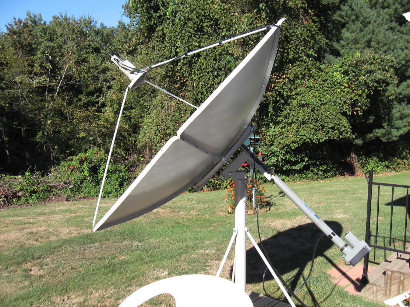

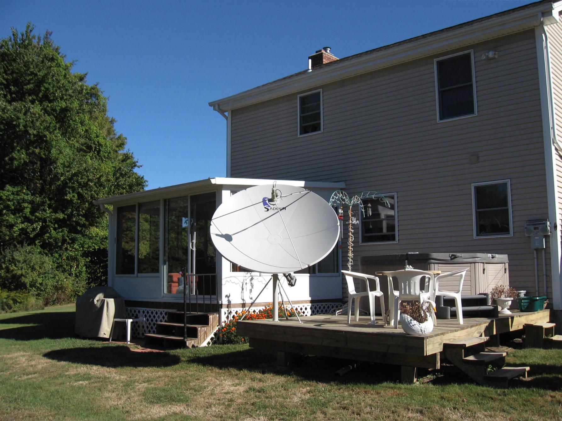

Heres a few pis of my 6 footer!The mast on mine is 3" diameter

That decision is really based upon where it will finally sit, but the rule of thumb for KU or C Band is "out of any people traffic area where anyone can walk into it or hit or bump it.
I have a 1.2Meter (4ft) dish that I used a 8ft pole with that I put 2 1/2 ft in the ground. It's okay, but really too low. I can barely get under it to mow on my riding mower. All the other dishes are backed against shrubs and high enough to not be a problem.
So my suggestion for a C Band is always at least a 10ft pole minimum of which 3ft would be in the ground.
