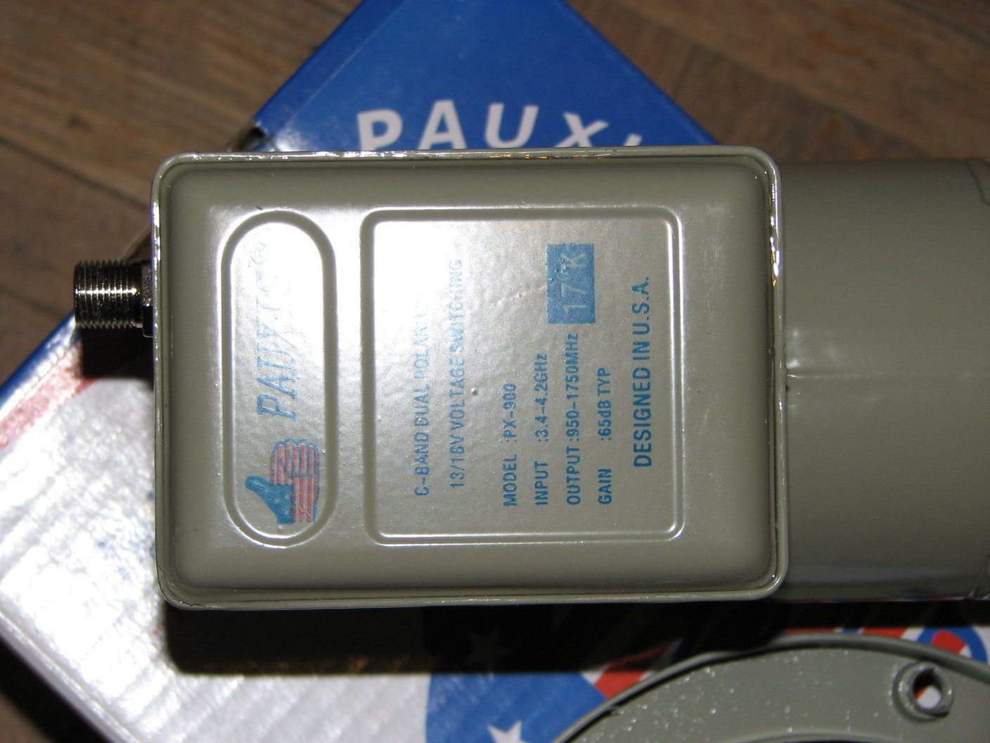

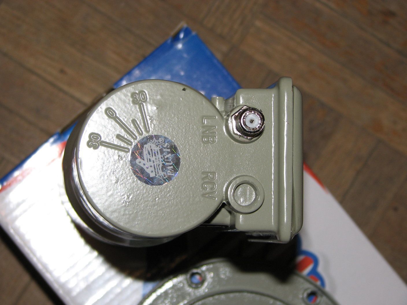

I dug up some pictures of the lnb box when I bought it and some pictures of the markings on the back of it.
