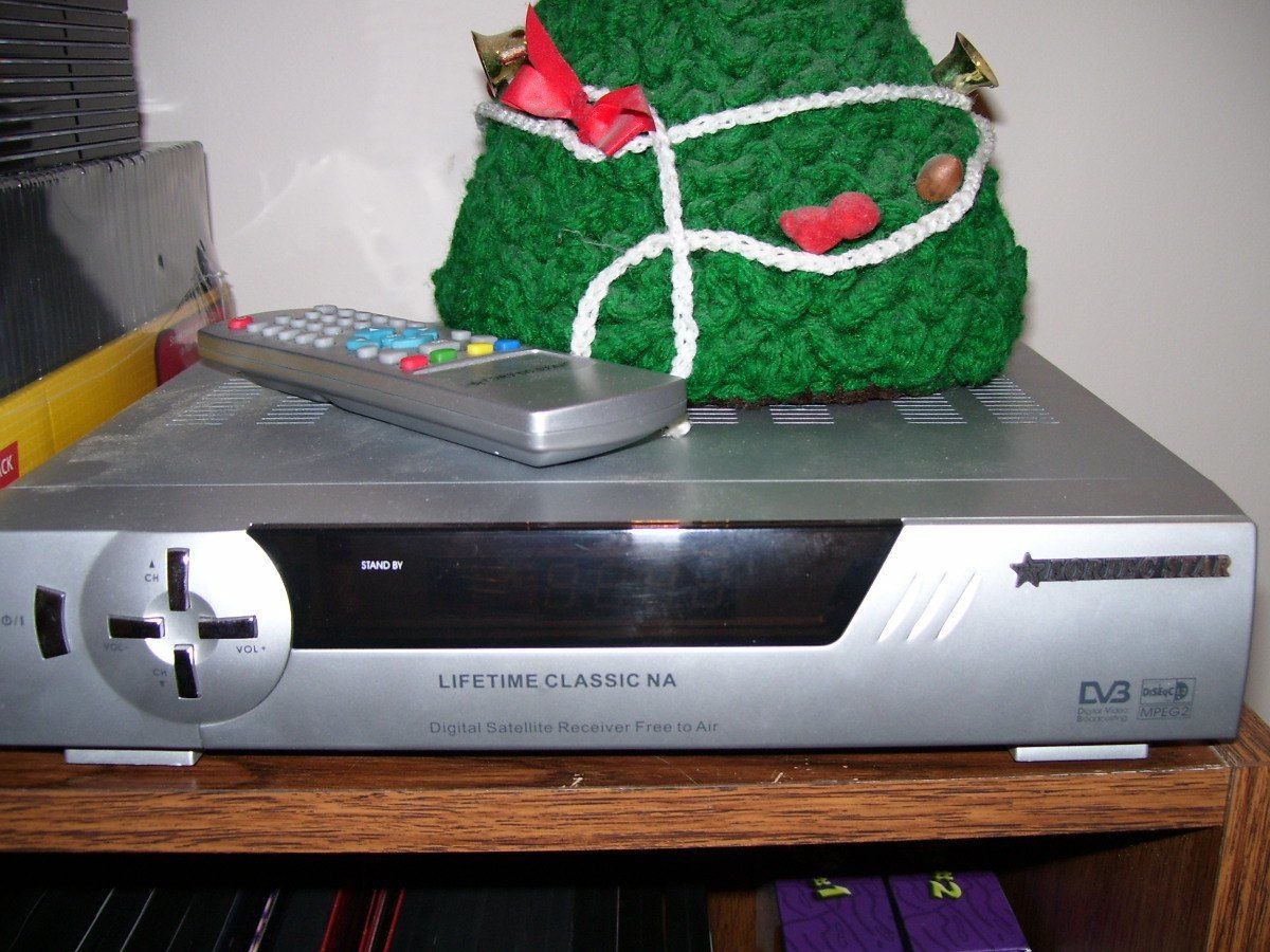

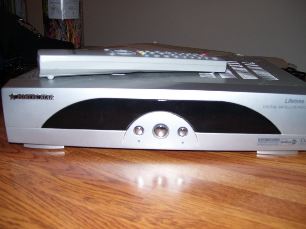

What does the box look like?
1st is a Lifetime Classic NA (no the christmas tree doesnt come with it) :)
2nd is the Lifetime Ultra
The 1st is the newer box
The problem child is the 2nd box. The first one is my new baby, and I'm not toughing her!!!! :)
