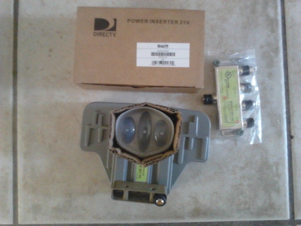

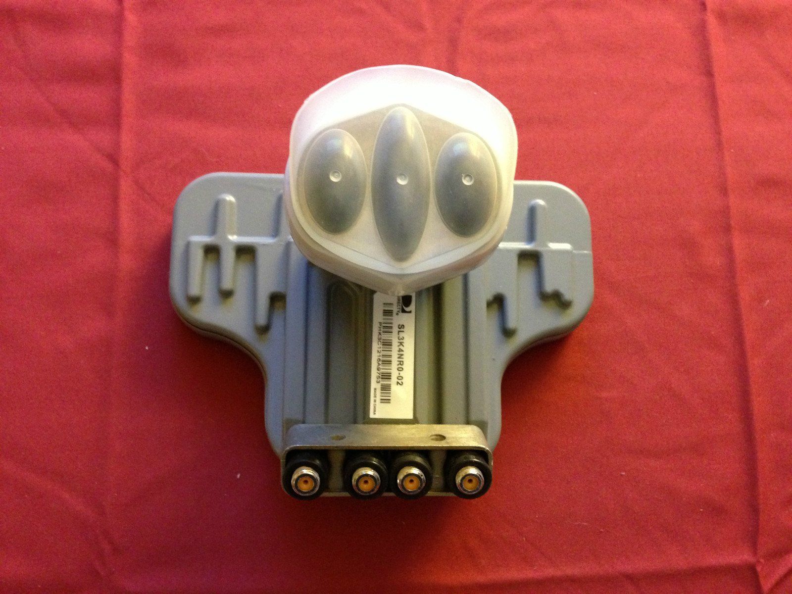

3 LNB set-up with 9 foot dish: 99W, 101W, 103W
I would like to do a three LNB set-up for 99W, 101W and 103W.
Due to my location I will have to use a 9 foot offset dish together with a 3sat Ka/Ku LNB.
Q: Do all these three satellites require a Ka/ku LNB?
Q: what is the difference between these two lnbs in the pictures (enclosed) ? ---> 4 outputs vs one output plus splitter
Q: Is there any satellite left for the old/regular Ku circular Lnbs ? I assume the 101W in the center of the 3in1 SWM Lnb in the picture is still Ku circular.
Q: Due to the larger size of the dish the 3in1 SWM Lnb might be too close together and I would need larger spacing. Any idea how to combine 3 separate lnbs ?
Thanks !
101 is Ku and uses a standard DirecTV LNB (circular polarization). 99 and 103 are Ka.
4 output is a legacy lnb, 1 output is swm. Theres alot of threads describing how each work, but since your using a 9' dish, not many people are going to be able to assist with settings or whatnot. I can tell you that the two lnbs you posted pick up 99/101/103. There is a different lnb that does all 5. But the 110 is pretty worthless. However 119 is needed for spanish programming. You may want that, im not sure where you are located. And for legal reasons i dont want to know. Im simply trying to assist in your setting up dtv using a 9' dish :)
What i would recommend is using the 4 output lnb and a swm8 multiswitch. You may also need a polarity locker or amp, i seem to recall you stating your dish was 200+ ft from your home. Swm doesnt work well over those distances.
That said, if you run your 4 lines into a polarity locker, then into a swm8 (at the point of your home) the swm would only travel the length of from the switch to the tv. You put that green splitter in the pic of the second lnb on the swm8 multiswitch then run one line to each tv. Use the lnb in pic1.
Maybe use rg11..
Sent from my PG06100 using Tapatalk 2
If he is uses a swm8 switch as you recommend, what's the need for the splitter?
vixens, I don't know if using a 9 ft dish will work. You may not be able to find a focus point for three satellites. Maybe with them being so closely spaced it's possible, but it won't be easy. Good luck though. Let us know how it goes.
twizt3dkitty Thank you.
1. yes I am planing to use RG11 for such long run. I have the same distance for FTA and Dish Pro; works fine.
2. good to learn that SWM does not travel long runs well. So I will go with Legacy.
