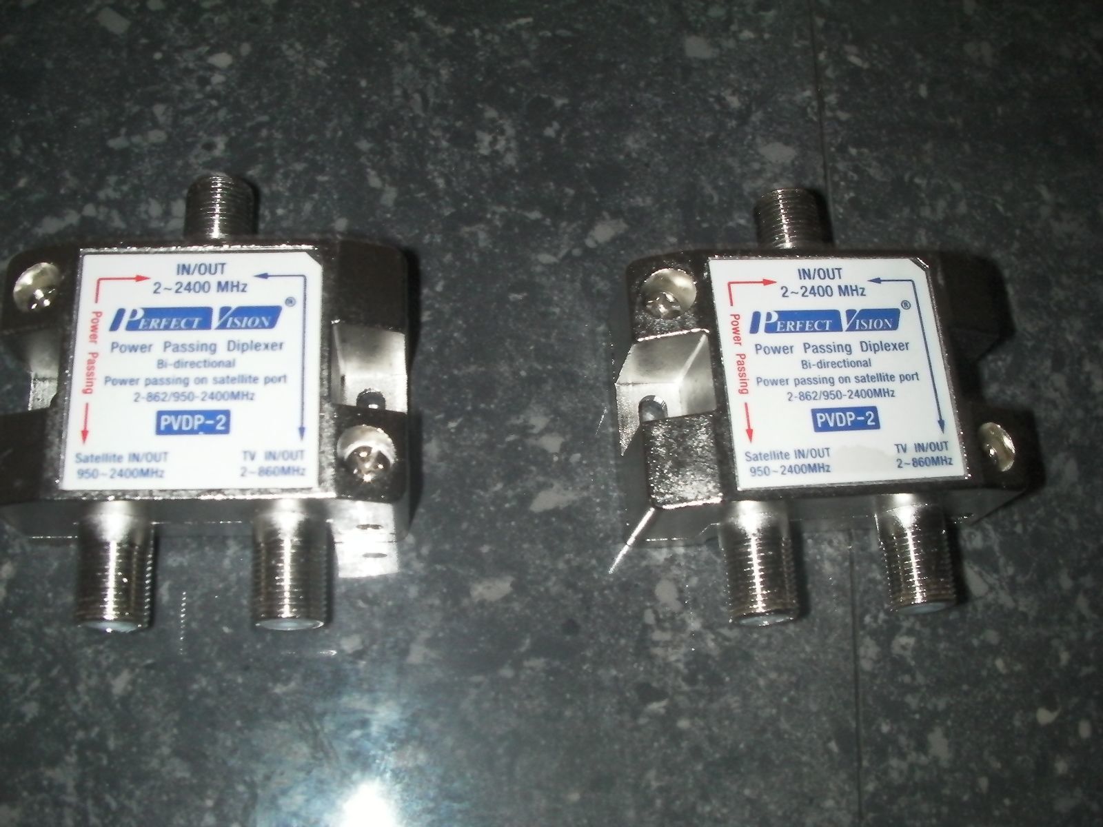

The question is: "what is this combiner/duplexer"

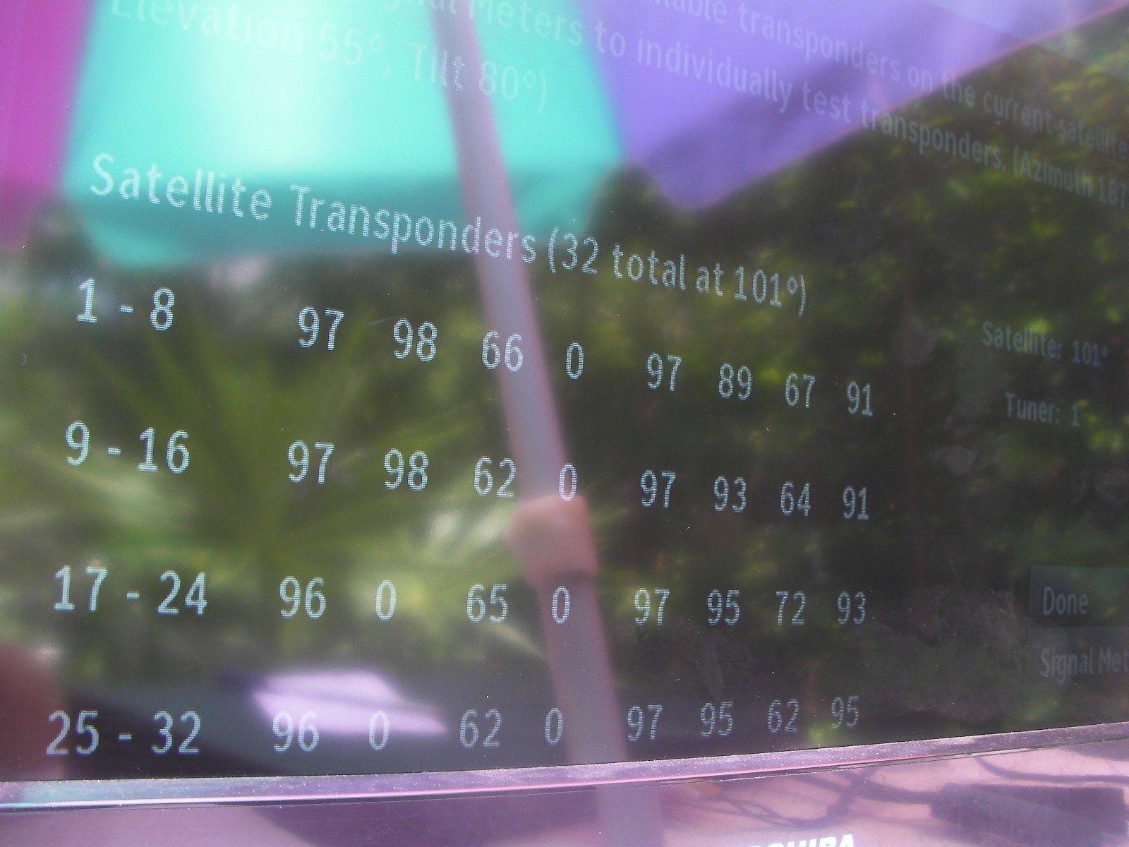

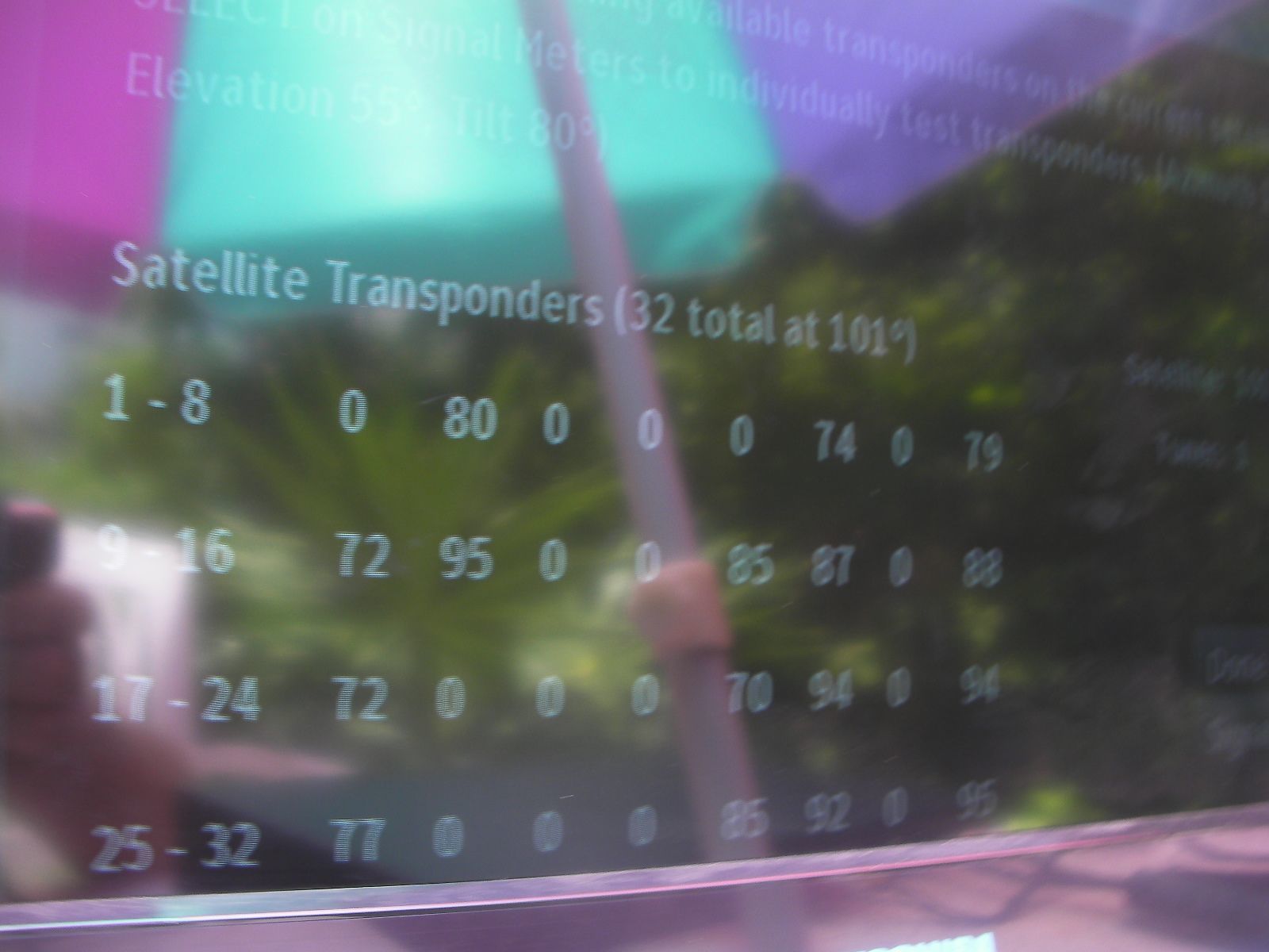

1.) I will need the right Diplexer/combiner. With the current switch I am loosing too many tps.
101W direct:
101W with switch:

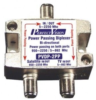

the diplexer I suggested was PVDP-2PP
The switches I have are PVDP-2.
Is there a difference ?
Ok, now I noticed the dual power passing while mine has power passing just on one side.
Will try to order the correct switches.

You're correct about the diplexers (they are not switches). You MUST have power passing on both ports otherwise both LNBs will not get power.

Please don't confuse switch with Diplexor, and when placing the order, even call if possible to be sure it has dual port power passing

As of now I have to unplug the 103 so the guide (coming from the 101) can get through. Once I plug the 103 back in, several tps from 101 are missing, amongst the tps for the guide.
