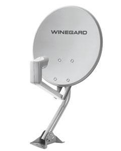

I want to purchase a fixed dish for the equity channels. It also needs to be as small as possible.
The largest I will go is 30 inches, smaller would be better.
My main problem is that the front door of my house points directly at 123W so if I place a dish on the side of my house the dish has to point directly at the front yard (the dish is perpendicular to the siding). Dishes don't work in the back yard and I don't want it in the front.
My 1 M dish could be mounted on the side of the house but it can only see to about 111 degrees before the house is in the way of moving it any further west. So I figure a smaller dish (lighter) could be mounted further out and the swivel the hole 180 degrees without hitting the house.
I hope I explained that well enough. I am starting to think it would be easier to put the dish way back there in the back yard so I could see over the house, but then I would have to run a wire.
Anyone have a LNB that is mounted like that winegard, of course it would be linear? Do those type of lnb's even work? How is the polarity adjusted? I am only asking, because those dishes look much better and the arm is much sturdier. That particular winegurd looks like a 18" but it is accutally a 30" designed for linear reception or so they say.
Find a used Superdish or Slimline D* dish. I think the Superdish would be better because I think it has a bandstacked linear LNB on it already. I tried a D* slimline on 123 with a jury-rigged LNB and it didn't work too well, but I think it was because I didn't have the LNB mounted correctly. I have heard from other folks that use or have used a Superdish with no problems, although I don't think it would be very good rain-fade wise.
