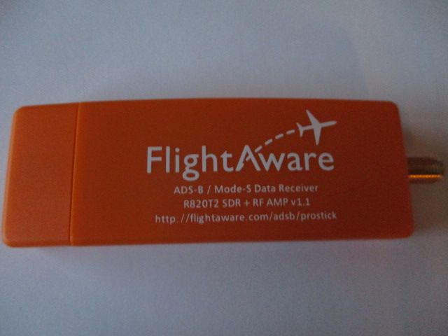

Just got the FlightAware ProStick SDR dongle to see if it works any better than the RTL-SDR.com dongle I've been using for the past few years for ADS-B reception. It has an internal LNA to boost the signal at 1090 MHz. In the past I used the RTL-SDR dongle plus an outboard preamp to increase range but the FlightAware eliminates that add-on.
Now how well it'll work we will see. One other advantage is that the ProStick works with SDR# and it appears to have better sensitivity on UHF. I can hear NYC police in the 470 - 476 MHz band much better as the signals are stronger. Need a few months to see how well it works, especially on HF using a Nooelec up-converter.
FlightAware also makes the ProStick Plus which has a notch filter for 1090 MHz, but I feel at my QTH it's not needed. Wonder if anyone is tuning into ADS-B?

First impressions after trying it out last night using a roof mounted discone (25 - 3000 MHz) is that the range is greater than my previous SDR donglle. Am seeing more aircraft than before and farther out, some beyond 250 kM. Am using RTL1090 for data acquisition and ADSBScope for decoding it. The internal LNA of the Flightaware dongle seems to make a difference.
Better results would be had with an ADS-B antenna, but that is for another day.
Amazon product ASIN B01D1ZAP3C This is the one I got, without the ADS-B notch filter.
Well the FlightAware dongle works better than any previous SDR dongles I've used for receiving ADS-B. Definitely see more planes and those farther away. Am using a discone at the moment but an antenna specifically for ADS-B would be better. The transposed coaxial collinear antenna is a good one, can be made from RG6. There's a YouTube video on how to make one.
As for use with SDR# it works perfectly and is more sensitive on VHF/UHF, probably due to the internal LNA. Haven't tried the dongle on HF using an up-converter though, that is next.
