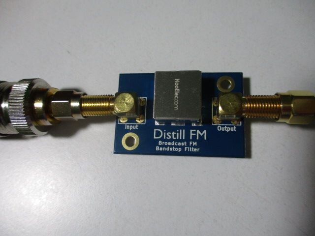

Bought one of these to reduce FM broadcast band interference that can occur when using a SDR dongle. It works pretty well.

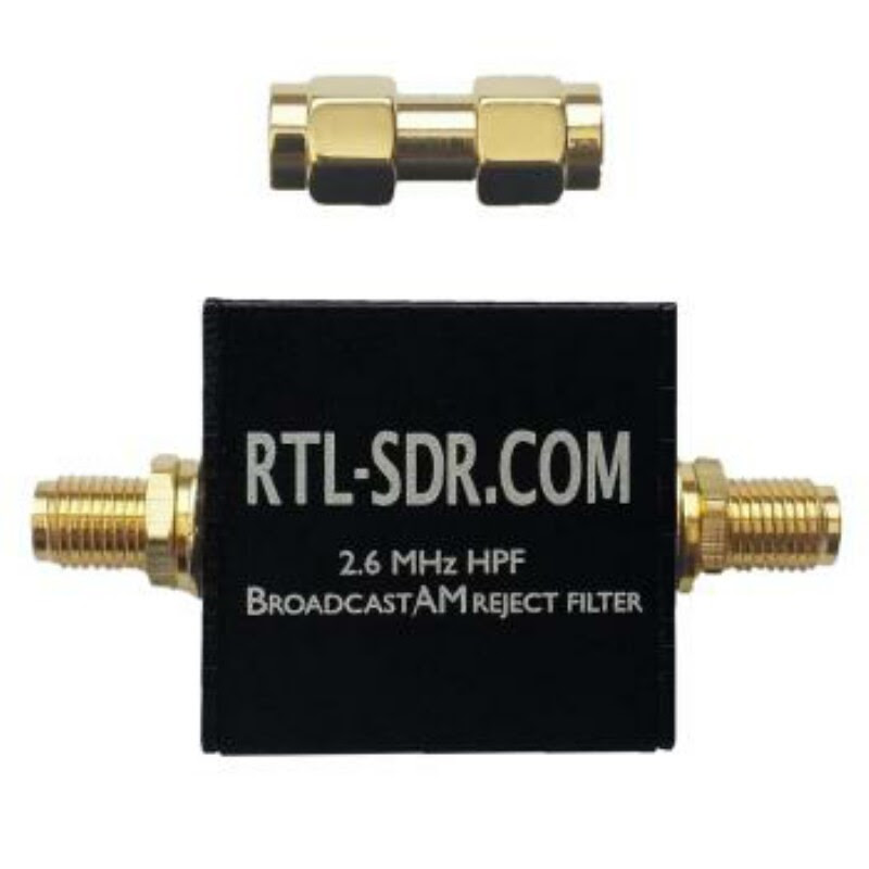

I recently bought this fiter. It works extremely well. The 75 foot long wire antenna picks up lots of signals and was over loading the SDR-RTL front end with mosltly AM band interference. With the filter, its like having a whole new radio. Short wave listening is clean and it appears the noise floor is also lower.
